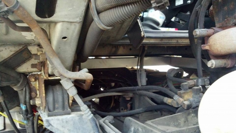

    Hey everyone. Thought I'd share my latest project. Frame under the sleeper started rotting and decided I'll replace it. Been a long 3 days, but I have new frame bolted to cab mounts. Getting back cross member welded tomorrow and the plates the shocks and air bags sit on welded up. If only I could weld...... any who here's some pictures of the old frame.
    IMG_3404693746048.jpg IMG_3404693746048.jpg IMG_3404693746048.jpg IMG_3404693746048.jpg IMG_3400213561730.jpg IMG_3414392922315.jpg IMG_3410285514621.jpg
    Sorry first time uploading pictures. The new frame I'll have pics Monday. Going with white paint. Worst case I decide I don't like it and repaint it. Would any of you attempted this or just have a shop do it? Just curious. All in I'm at approximately 300$ in for all material. Just time consuming.

    Only reason the frame rotted away was due to no protective coating on the inside of the tube. By the cab mounts, there was a hole on each flange approximately 3/4" in diameter. Small... but enough to allow the frame to rot away inside out over the life of the truck. I was able to reuse the flanges (tried mocking up my own, but needed a welder in the end and... well... I know what my welding is like) and created a slip to go over the new I-Beam. Powder coated the flanges, primed and painted I-beam flat white, and base plates for air bags and shocks is gloss white. Actually pretty much any part of the frame you can see from the side of the truck I made a gloss white.
    Just getting some angle iron welded up today to the rear cross member then bolt the last bit up and hopefully be done with this Monday night. Will have final pictures after all is bolted up.

    Job is finally done. Test drove truck on 3 trips. Bobtails 100x better, empty w/ trailer is smooth and fully loaded it's night and day difference! Up next will be new shocks and air bags.
    Really pleased with how this ended up. Never thought I'd ever be doing this though. I plan to do a write up, and hopefully others who attempt on their truck will have an easier time.
    I'd do this again if I had to.... :)
