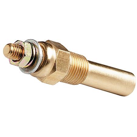

    I have also used a temperature sending unit in the plug hole.
