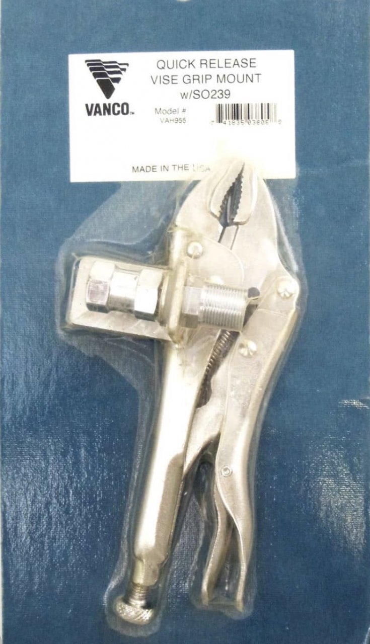

    Company regional trucks use to do this since they drove a different truck on regular bases:

    i forgot all about those that may be my answer thank you.

    Probably not a good solution. Volvo mirror arms are painted so grounding would be nearly impossible.
