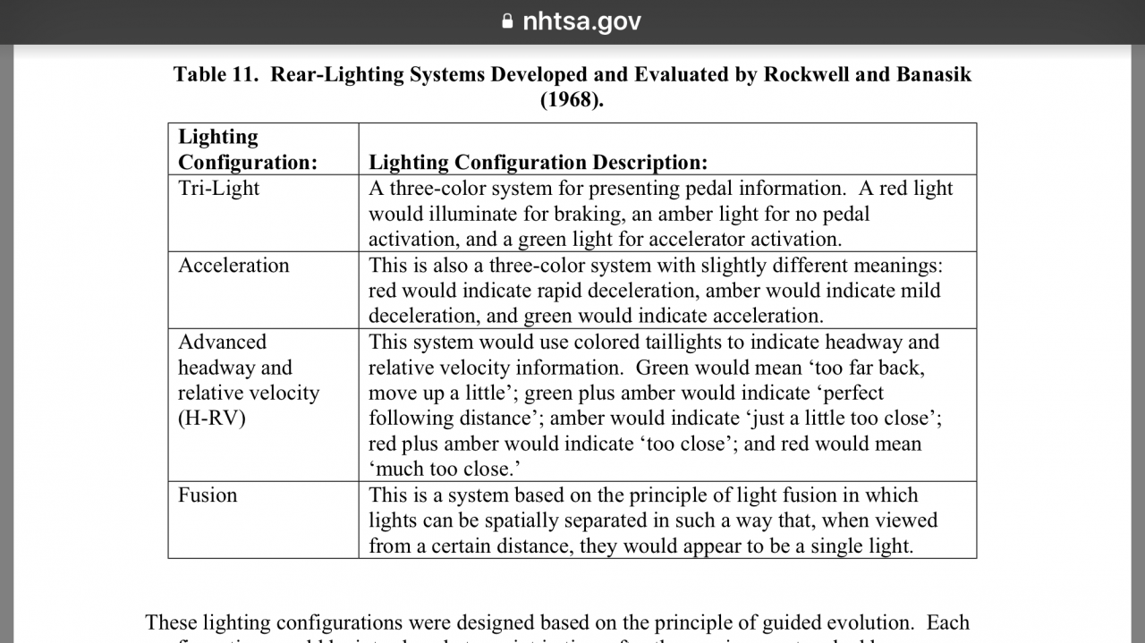

    Here's something interesting that they were toying around with in ‘68 when they were doing studies for the new 121 brake system standard C1E6C8C9-3348-4834-9DB2-15B57FCDFDF0.png

    Also read in that site that in 2001 someone had applied for a patent on a device that would allow the tailights to change brightness levels with decel rates.
    In otherwords get brighter the harder you brake. It would also allow the lights to brighten slightly with any decel event without service brake application.
    It did however state that the patent was not issued.

    This would certainly contradict OldMan
  8. SmallPackage
    5,535
    17,636
    Dec 20, 2019
    Marion Texas
    Not tying to contradict anyone. Just found it interesting. Also goes to show that the engineers in the automotive world don’t sleep and keep trying to reinvent what is perfectly fine already.
    Just imagine the confusion of that light system mixed in with all the other light clutter around the roads. Hard to tell now with Amber turns on the tails sometimes whether something is coming at you or away from you.

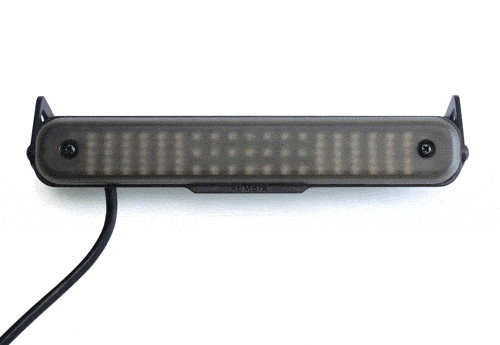

    Guys here in town make this for motorcycles. It has a modulating brake light and an accelerometer that can be set from off to various levels of sensitivity to turn the brake lights on when decelerating without using the brakes.
    Motorcycle deceleration light bar - AdMore Lighting Inc.
    SmallPackage and snowwy Thank this.
