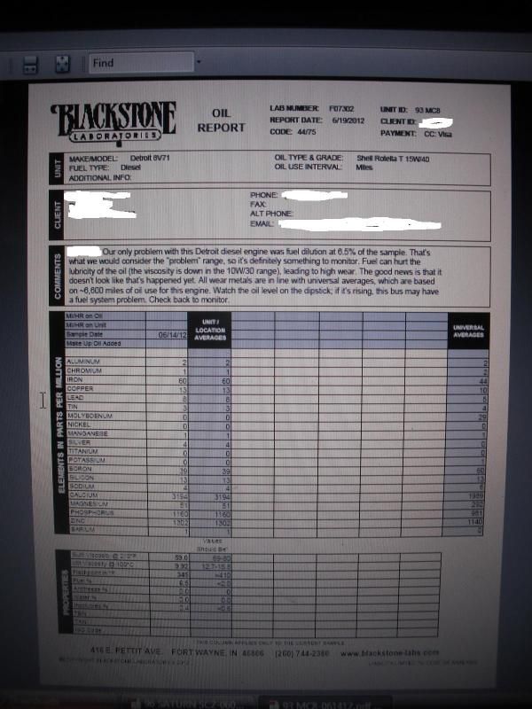

    Let me answer a couple posts here. SAE 40 is thicker when cold than 15W40, which is why it is thick. Even in 30 degree weather, I can still start a 6V92T with SAE 40 with no block heater or ether.
    I will be posting an oil analysis shortly from my 8v71 that had 15W40, it had fuel dilution of 6.5% causing the oil to turn into a 10W30.

    Here is an oil analysis of 15W40 before I changed it to SAE in an 8v71N I just picked up.
