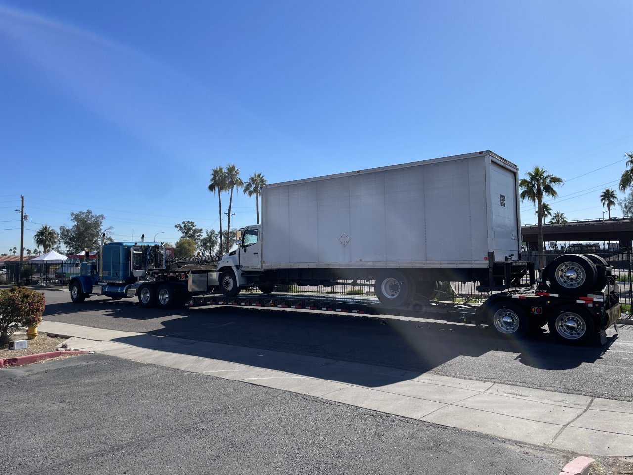

    Just out of curiosity is anyone running a set up like this? The 10’ spans are a 40,000 lb capacity, I’m guessing at 300lbs a set they are kind of bulky to move around by hand. I also see in the pictures they are bolted to the deck somehow. Can anyone give me real world experience with them? Thank you

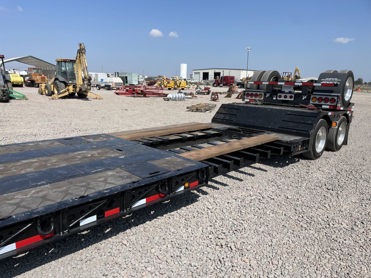

    I checked into those. Crazy expensive. Like $25 grand for the pair. Then I tried to have someone build them for me, and no one wanted the liability. They looked cool, but very bulky and clumsy to deal with. So I ended up with these “in riggers” or so they called them. I got them through XL. You can buy as many as you need. I bought 16 of them, for like $6 grand. Funny thing is, XL wouldn’t give me a weight rating on them, so I figured I’d run them 12” on center, like the deck. They’re pretty stout. They don’t take up a bunch of room, and they set up and break down quick.

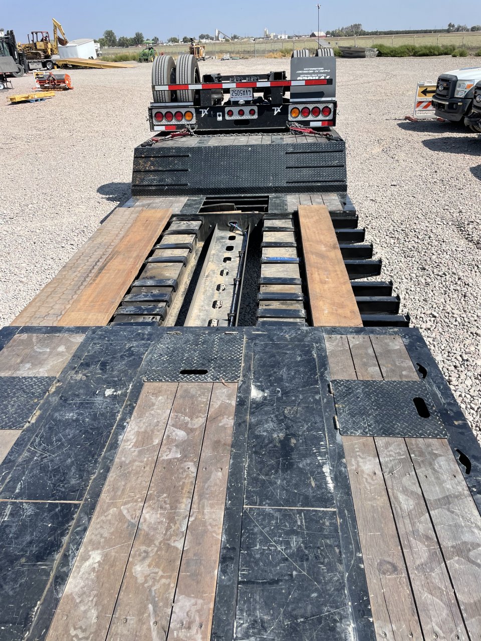

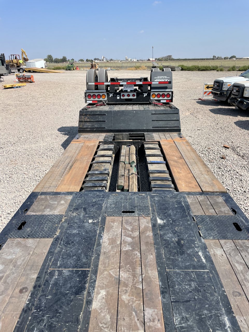

    Here’s how I store them on the neck. You’ll have to zoom in… 646929E8-5DB5-4EC6-B88E-598C91A49B19.jpeg 17281803-8DE3-4681-B759-F0E818B59344.jpeg
