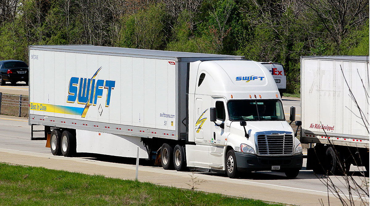

    If trucks were ladies, which one you wanna spin around the dance floor? swift-main.jpg tumblr_nrz1svm2Ke1thrmx5o1_1280.jpg
