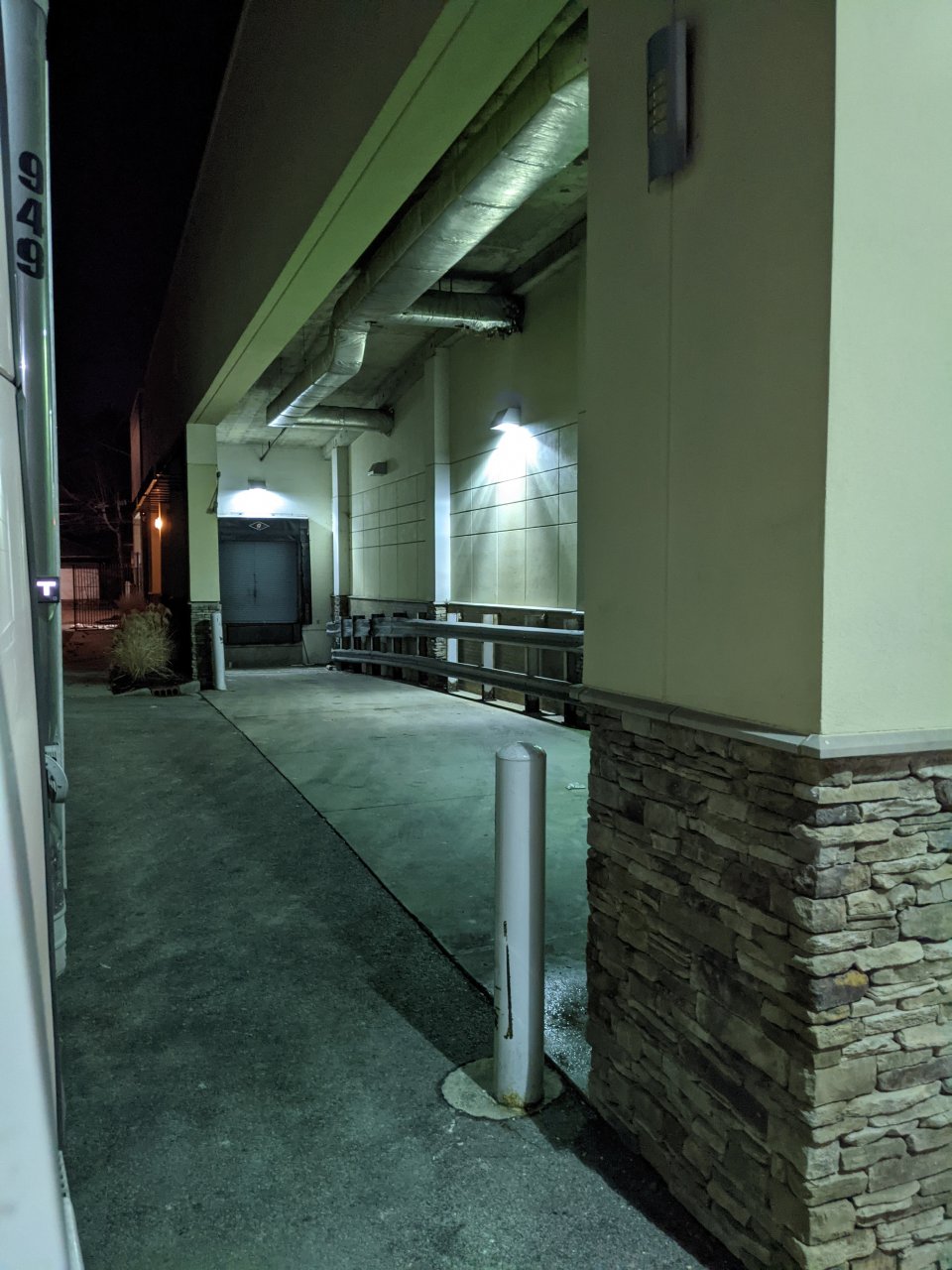

    While not in a semi, but in a bus, I had a chance to take this picture today.
    I was forced into an alley dock today and the front tire tracks are useful in trying to make a point.
    Note how much the front tire offtracks. In a semi your drive tires would need to do the same.
    One of the most common issues I see is that people don't:
    A) realize how far a semi must move before the trailer responds (about 10 feet)
    B) waste a lot of space by rolling while turning the wheel.
    As others have mentioned learning to back is not a spectator sport. It requires practice.

  9. gekko1323
    gekko1323 Road Train Member
    1,670
    2,785
    Jul 14, 2018
    Henderson, NV
    Wow! Where is that? I think I've been there!

  11. Snailexpress
    2,675
    6,069
    Apr 28, 2014
    Rocky
    Market Fresh Indianapolis.
