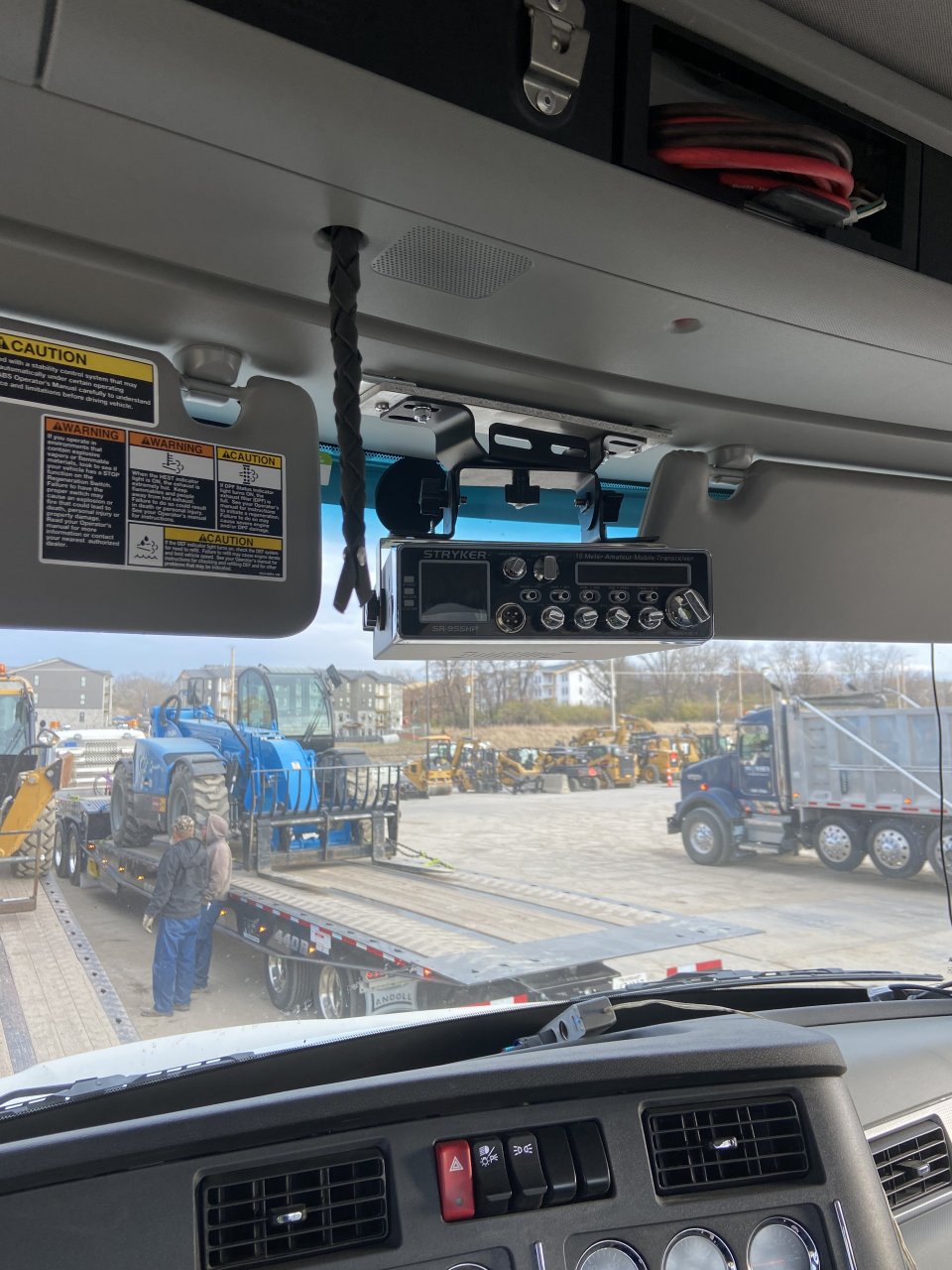

    5C4864F5-5C28-4242-AD1B-3197FEAE71BB.jpeg Got the 955 in place now to just finish wiring it up and running new coax.

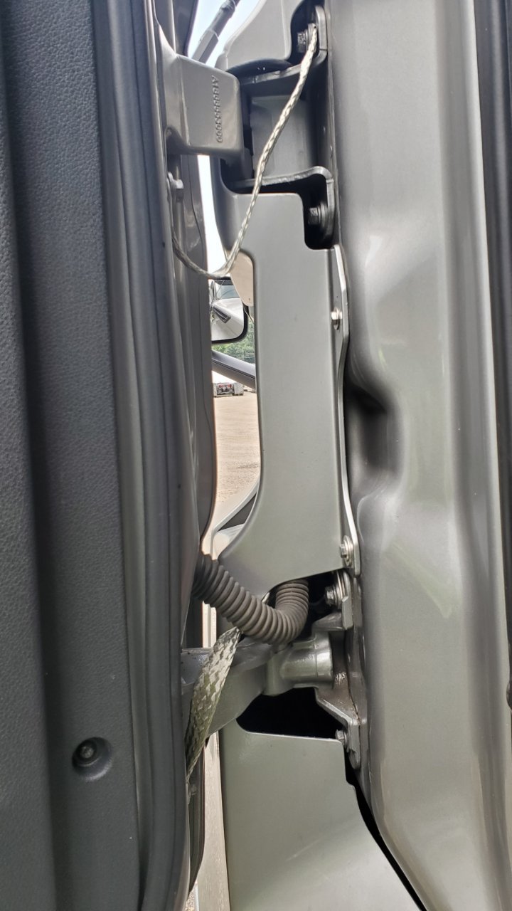

    Pay extra attention to your antenna system with this radio, especially in a newer truck. Failure to do so will result in your disappointment in your new Stryker's performance. Like Craig said bonding is part of it.Short ground straps on the door hinges is a good place to start. Example of what I have done on my Cascadia......
    Antenna placement and mounting is crucial. Look around on YouTube for videos regarding installing an antenna on your truck.
    This might sound like we are over complicating this, but you have invested a good deal of hard earned cash in your Stryker and it would be a shame to blow it up with an antenna system not worthy of your radio.
    Good luck!
    JD

    Nice install radio will get ventilation but also could draw Attention from a thief
    chriskc Thanks this.
  8. stacks
    stacks Road Train Member
    1,501
    814
    Oct 27, 2011
    Emerald Isle
    I like the Bracket Looks like the radio can be turned at desired Angle

    Well locks only keep honest people out. I like the fact I can put it at the angle I wanted to. I just ordered a 10k dual coil and putting it on my headache rack with bonding the rack to the frame.
