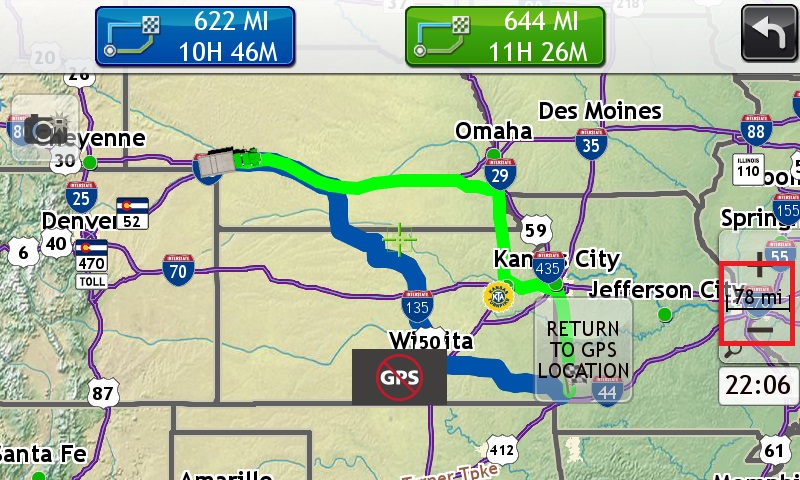

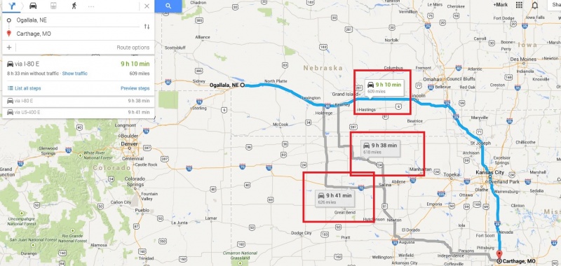

    I put in the same route and all the settings take a little over 600 miles. Google Maps shows the same.
    This is compare with St. Louis in the red box.
    Under Preferences/Route you can vary your settings such as avoid freeways or prefer freeways.

    I have screen shots, hopefully they came out good enough to see, I was driving at the time. =\
    This is my second TND first one was the 500 now Ive got the 720LM, I in for the long run but I dont know what your settings are but I do not get the same results.
    I also update the maps, and construction data all the time.
    How do you do a mock run like you are doing with no GPS?
