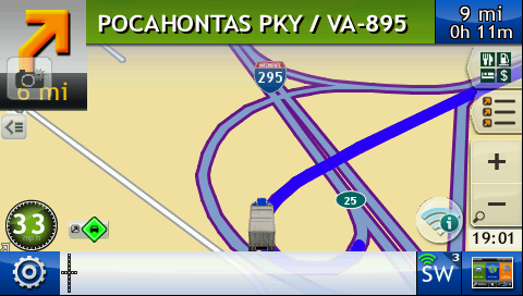

    Anybody have issue with your unit just not liking certain routes? My 520 just doesn't like to use a specific route in my area which is a huge cut across (895/Pocahontas Parkway) not a real parkway, it's a highway/toll road and I don't have toll roads shut off. I constantly get routed around it which adds and many times doubles my trips.
    Here I was on 295 heading back to my terminal and as you can see I'm literally driving over 895, the road it doesn't like. It's way had me driving back to 64 and total trip mileage was 23mi.
    So ignoring that I got on the 895 exit and from the screenshot you can still it almost immediately rerouted me that way dropping the trip to 9mi and a 3rd of the time.
