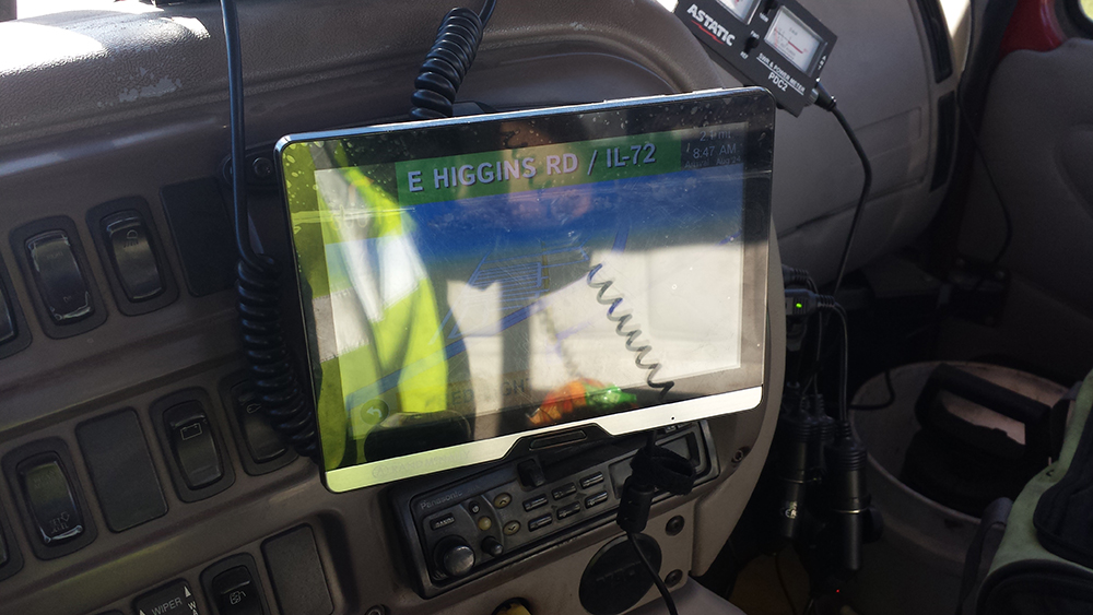

    The morning sun shining through all four sides of my day cab reflects like crazy on the glossy screen of the Tablet. A little top shade would not help this. No shade would because the screen reflects from all angles. I was wondering if a matte finish would help? do they sell that and would it still work as a touch screen? Or do I just have to put curtains up. LOL
    That curly cue wire on the screen is the reflection of the cord from my phone while I'm taking this picture. I really can't read the map like this.
    PS and you can see the crease I made while installing the screen protector
