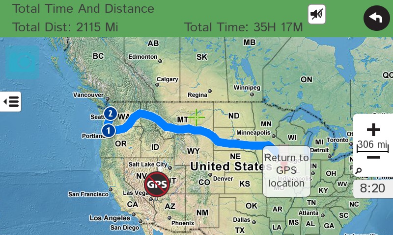

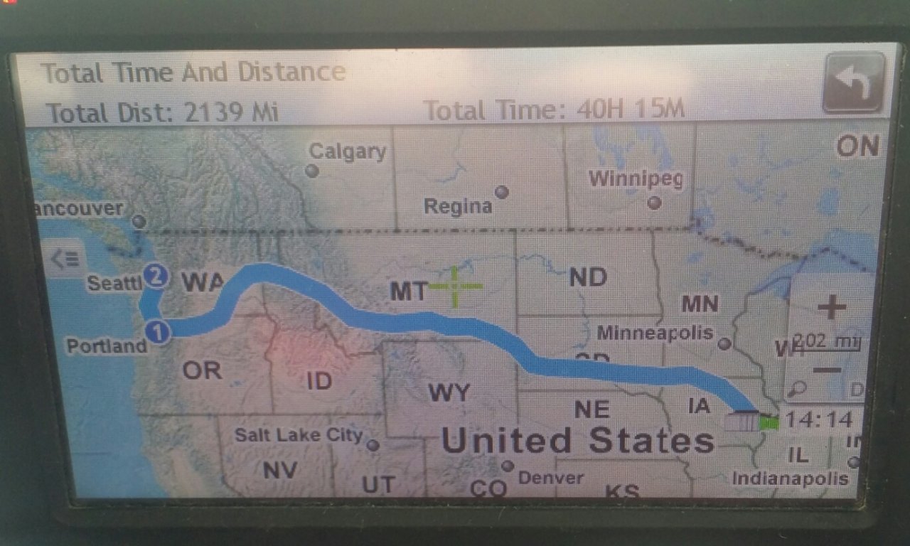

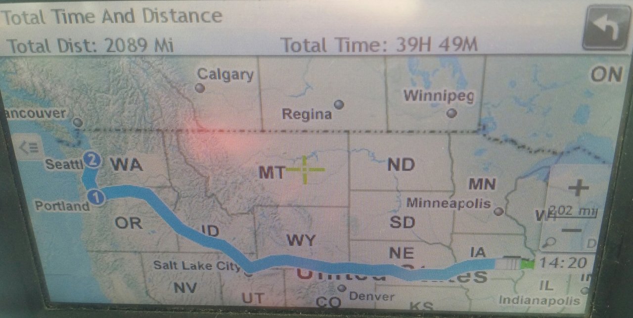

    Another shortest/fastest routing bug:
    West Branch, IA to Portland, OR to Seattle, WA
    Fastest is longer and slower: 20150917_121808.jpg
    Shortest:

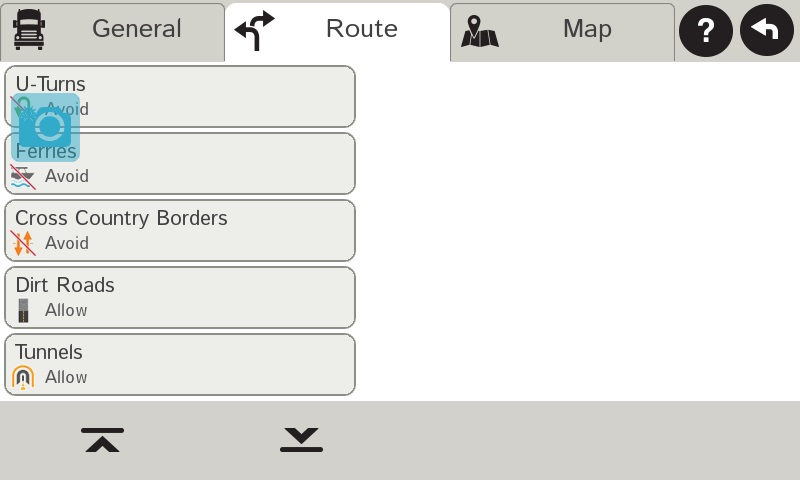

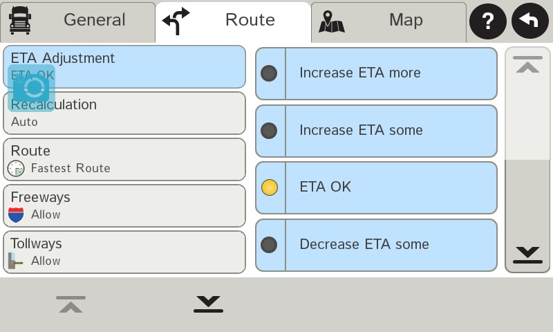

    Not knowing your settings, I got this.
    Thanks,
    Mark
