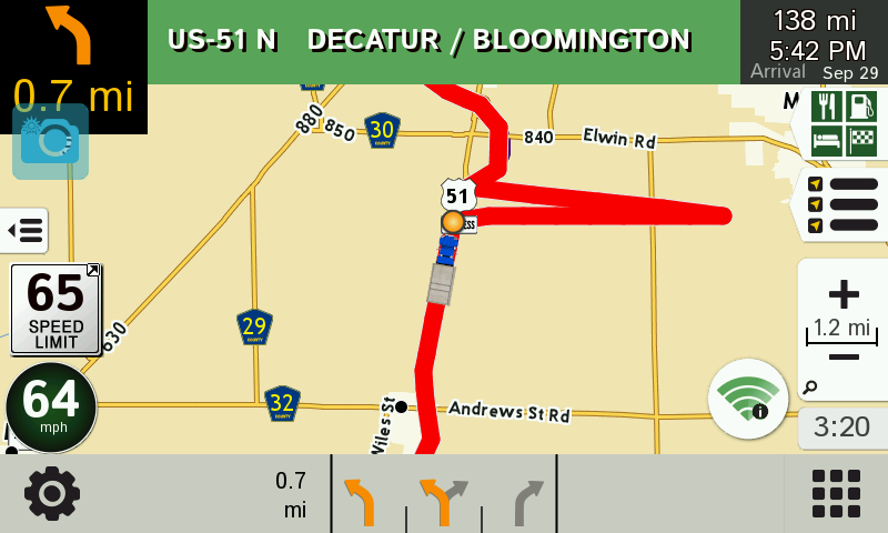

Here is a map issue that appears on my 730. This is just South of Decatur, Illinois on US 51. Northbound only.
![[IMG]](proxy.php?image=http%3A%2F%2Fwww.thetruckersreport.com%2Ftruckingindustryforum%2Fdata%2Fattachments%2F80%2F80397-33ed3c0a4f50e00cf181a2559df9b834.jpg&hash=f18e16fe4986f5f6e49320011ecd1385)
![[IMG]](proxy.php?image=http%3A%2F%2Fwww.thetruckersreport.com%2Ftruckingindustryforum%2Fdata%2Fattachments%2F80%2F80398-da309f69545b9ed15b47a9ca111b147b.jpg&hash=a6847fa14c240dbaa5cd60d42e69e340)
![[IMG]](proxy.php?image=http%3A%2F%2Fwww.thetruckersreport.com%2Ftruckingindustryforum%2Fdata%2Fattachments%2F80%2F80400-4bc850d7036d73809ed7be49a21f0221.jpg&hash=f648166b98bfe9ae09ae3718e197a5ae)
Thanks!Attached Files:
