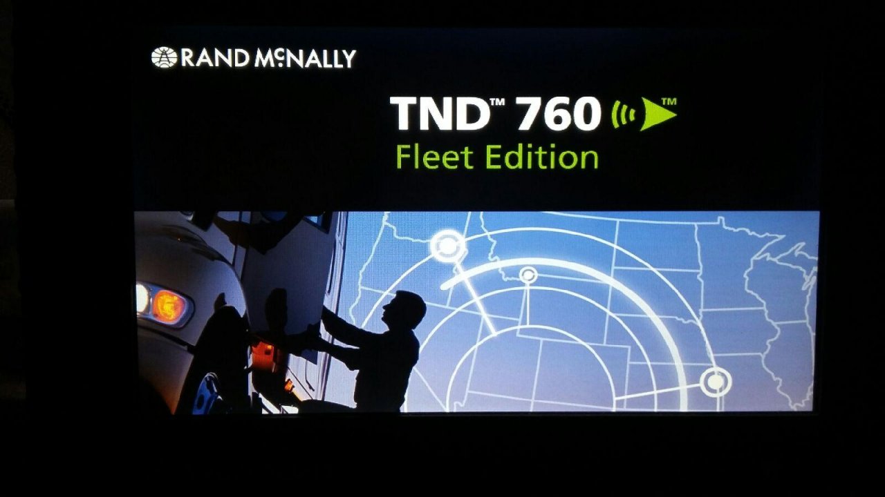

    Many of the drivers in our terminal are running the 760 fleet edition, updated last week. MANY problems with freezing. Yesterday my brother tried to boot it up and it only gets to the welcome screen. Tried unplugging it overnight, no change.
