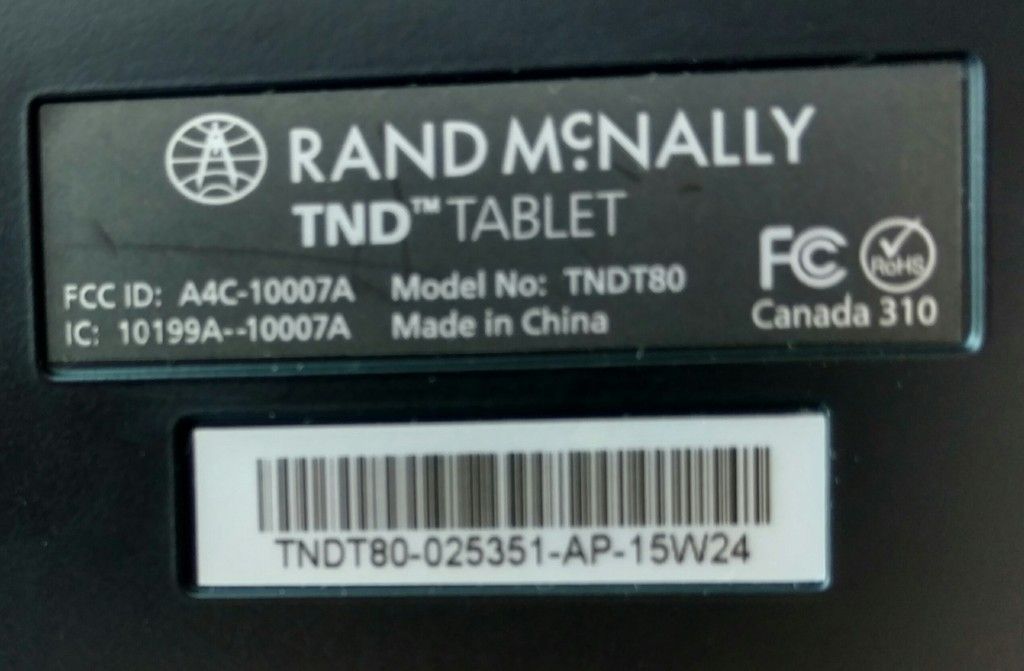

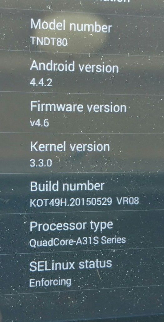

    I do not know how to find the version # of the maps I have on the unit but I did update it within the last 3 months.
    Please note that I AM NOT bashing the TND in any way. What I say below is honest feedback from a person that has been using moving map GPS since the early 90s when you had to have a laptop with an external GPS unit in order to get it done. If i recall correctly it was RM software that i was using at the time. I do know that when I started it was the very first version they released. Later came an upgrade where a small yellow GPS unit/antenna powered by an internal battery was offered and you could then do away with the other GPS unit you were using. Of course the internal battery was a fiasco so i did a field upgrade to replace the stupid internal battery with a power cord to provide the correct voltage to the unit. (Probably voided the warranty... LOL) Back then no GPS actually had usable road maps, mostly all they gave you was lat/lon numbers and had a port for connection to something (a laptop for example) that could then use that information to create a location on something looking pretty much like an actual road map. I have owned many different brands and models of stand alone GPS units over the years, probably 40-50 in total.
    Now about my TND...
    The first and most critical issue I have with this unit is trying to keep it charged.
    I have a dedicated plug wired into a constant hot at the fuse box. The unit would run for awhile then shut off. Even leaving it pluged in and turned off overnight the next morning it would have maybe 20-30% charge.
    I looked at the tiny contacts on the back of the unit and they appear dirty. It is impossible to give them a good cleaning because they are at the bottom of a small hole in the plastic case.
    Fortunately RM provided an alternative port on the unit itself. I plugged into that and there was a small improvement.
    I replaced the factory provided charger with one rated 3.1 amps that has an integral amp meter. Now the unit stays charged to 100% all the time. But only when plugged directly into the unit, not the base. So much for the cool quick remove, no wires to mess with mounting base feature.
    In MHO the pin contacts on the back of the unit is a poor design in that it is not able to be successfully cleaned. Not MHO but obvious fact is that the charger is not up to the task it was provided to do.

    Thanks for the reply.
    A fair amount of that I knew/understand.
    "Slice"? Is that the mount? Still does not explain the power cord issue though?

    The Slice powers the Tablet (what slides on the mount) and provides a GPS receiver Boost. If the Tablet will charge on the side but not via the Slice, then the Slice is bad. If you suspect also the DC cord you can ask RM CS for one also.
