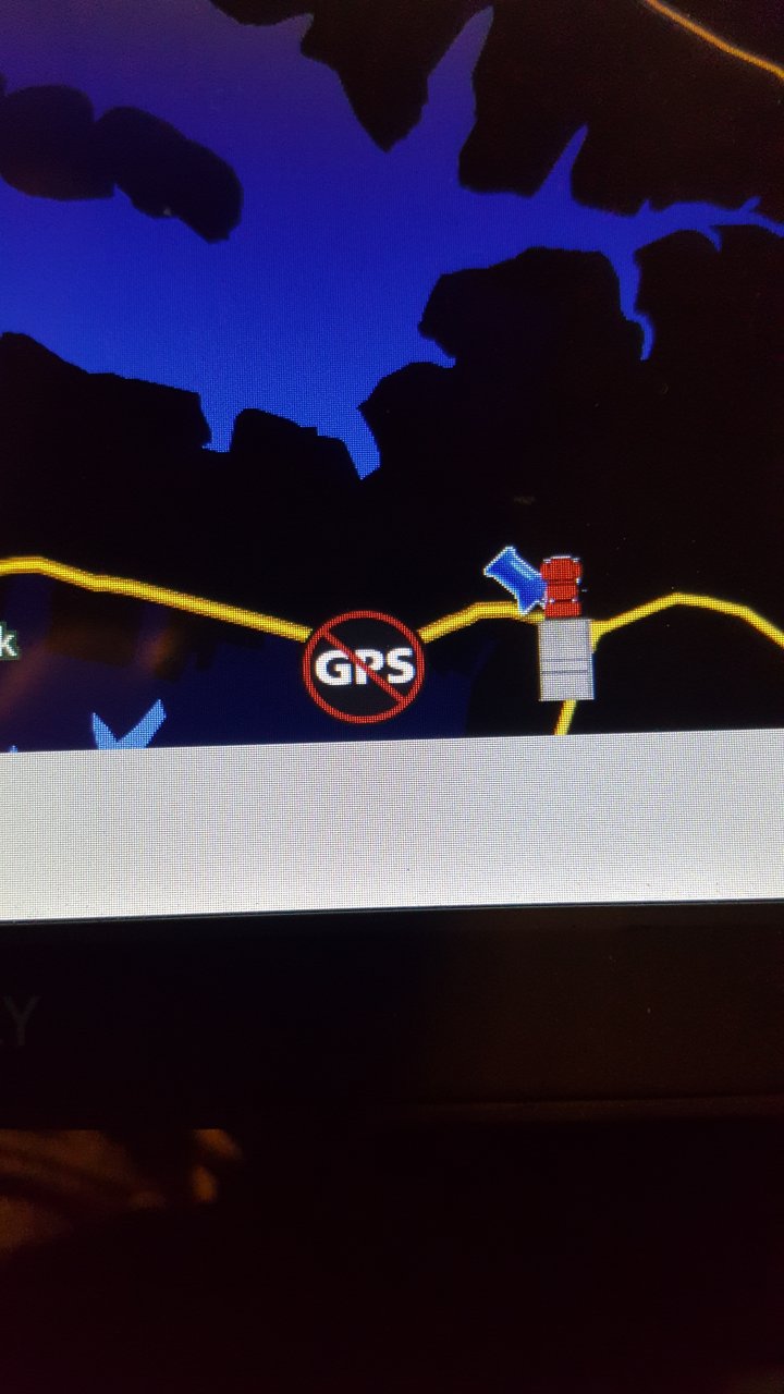

    TND730 took a few days off.
    Unplugged it.
    Got back to truck plugged it back in hasn't worked since.
    NO GPS Signal.
    Battery Fully Charged.
    Tried Diagnostic and Repair. Fixed a few files but no change.
    Updated a few files
    Also tried the Reset Button a few times.
    evidently TTR didn't like this one so.
    http://i63.tinypic.com/9jk67r.jpg

    Did you let it charge back up before turning it on? It has to charge a battery and run an HD screen at the same time... when you do turn it on press the reset and the on/off button for about 10 seconds.
    Thanks,
    Mark
    Balakov100 Thanks this.

    Edit didn't work initially but it decided to start working again after I played with the lighter plug
    Mark Kling Thanks this.
