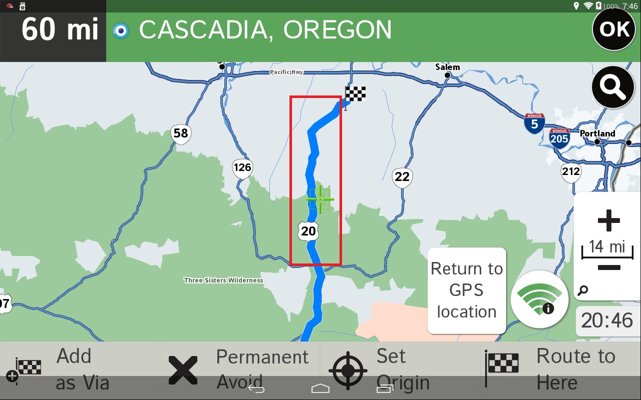

    I totally agree with your post. Routing on the Rand has always been my major beef with the product. I really like the layout so have never gone to the Garmin but it should be easier to plot your own route so you don't get sent on a sightseeing trip wasting precious time and miles thereby running down your HOS hours eg: the other day Redmond OR to Lebanon OR, the TND 730 wanted to go 126 to 20 to 22 to 226 and back to the 20 which was 123 mi and 2 hrs 43 min, whereas going 126 to 20 was 107 mi. and 2 hrs 17 min, wacky routing. Anyone who would blindly follow their GPS without double checking their route on their Atlas would be wasting precious time.

    The route it shows is set for 53'/102", but I changed to 48'/96" and it went to 126/20.. so I suspect that that portion of 20 is Non-Staa... I will verify.
    Non-STAA settings.
    Thanks,
    Mark

    When the destination was changed to the Pioneer Truck Plaza on the 228 near Brownsville OR the unit correctly routed 126 to 20 to 228.

    You did not say this first... I would suspect then that 20 has a lower weight than 22 to allow the router to pick it first. I am verifying this.

    US-20 is non-STAA from east of Sweet Home to the west junction with OR-126

    OK, if this is correct then why would it route that stretch to get to the Pioneer Truck Plaza but not to Lebanon. Just seems a little confusing.
