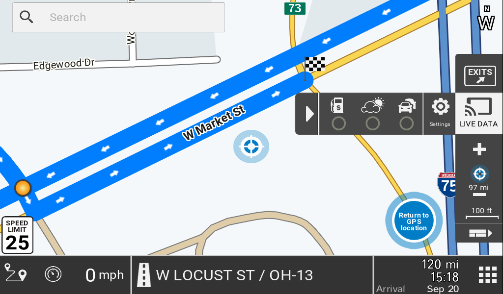

I tried the same route, it took me to exit 73. (Freeway - Allow) Shortest/fastest took exit 73. What are your settings?

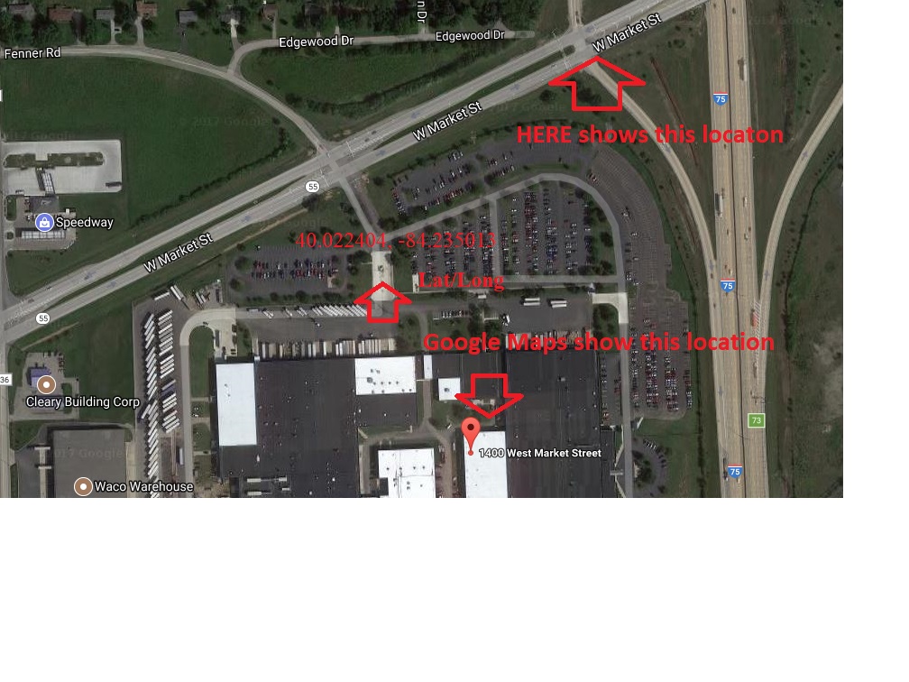

If you look at the Destination Flag, it shows at the point of the ramps and W. Market St.
40.022404, -84.235013 is the Lat/Long to the Entrance.
Looking at Google Maps, it shows the actual location of 1400 W. Market St, in the middle of the building.
So, in this instance I would have suggested that you use the Lat/Long to route to the main gate.
On Google Maps, find your location, Main entrance, dock, etc and place the mouse on it, right click, what's here, Lat/Long is at the bottom...

Now back to the routing you say is incorrect. The way they make the Maps they do not find every business/house address and pinpoint them. Millions upon millions of them, so they take what they sometimes refer to as a Postal Address. I live at 207, but my neighbor is 213 and the other side is 201. The street is subdivided into equal parcels. So on that road the number may fall at that location.

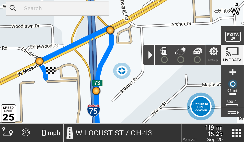

Now since the other was too many "Steps", do this. On your 740 on the map screen, at the upper right you will see a "highway" with 3 lines under it. Tap on that. Scroll down till you see the destination. Tap on that, you will see the map screen on the left now showing the destination. You can on the map screen on the left "finger" in or out to zoom in/out. If you long press on the "bulls eye" it will take you to the full map screen. Move the "bulls eye" to the location you need to be as your destination. Long press and you will see at the top of the Pop Up - "Route to Here". Now when you look at the route it now takes you to the correct location. If you go to this often you can save also in your Address Book.
I put in your settings and I still show exit 73. What Truck settings are you using? Do you have any Avoids set for this area? - You can check in your preferences.
