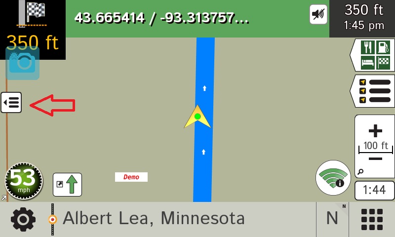

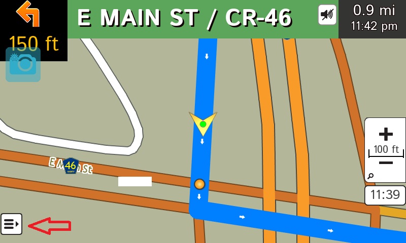

    I saw on another thread that someone mentioned that the Map screen is too cluttered. On the 530/730 there is a button on the map screen to assist in this.
    It should be on the 520/720 also I think on the next released version.
    Thanks,
    mark
