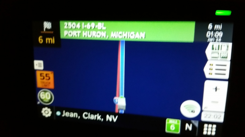

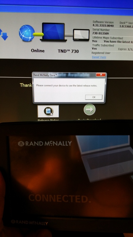

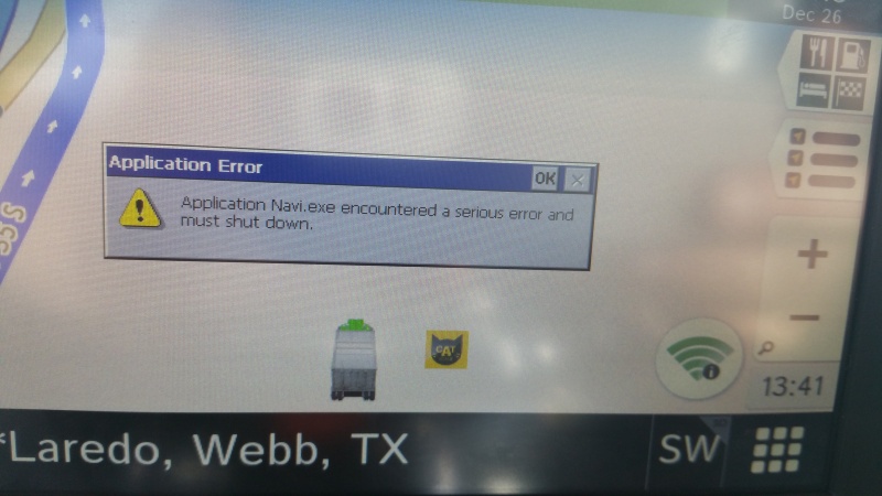

    I bought a 730, to replace my 720, and I'm greeted with this.
    It happens about twice every hour.
    I can replace it, but I paid for Traffic subscription, and from what I understand, it's not transferable to the new unit
    So, do I replace it, and loose $20 for traffic, or is this fixable?
    Also, since I posted this, there are couple more issues..
    First, it keeps connecting and disconnecting from computer (fully charged), USB cable from the box, original Rand cable...
    Second, routing issues...I was at the CA-NV border, heading for Port Huron, MI - Sarnia, ON border (Blue Water Bridge) and it decided I have six miles to the border....

    Do you get this if you are not running traffic, weather, or fuel?
    Odd on the mileage..
    Is there a way you could send me your Navi/logs?
    As far as the issue of not staying connected, what kind of computer do you have? If a newer 64bit/win 7 or win 8, they limit the power to the USB Ports. You can make sure your computer is set to high power in the power settings and also try connecting the 730 (on) to the computer and then turn the computer on.
    More drastic means might be to disassociate the Drive letters from the ports and then let them reassign. This is done in the registry.
