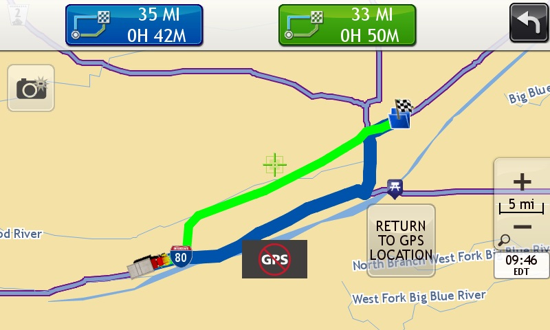

    1st one - newest maps (not published).
    2nd one - you are in compare routes. The logic is different for each thought process of picking a route. One will be a more direct and the other a "work around".
    Thanks,

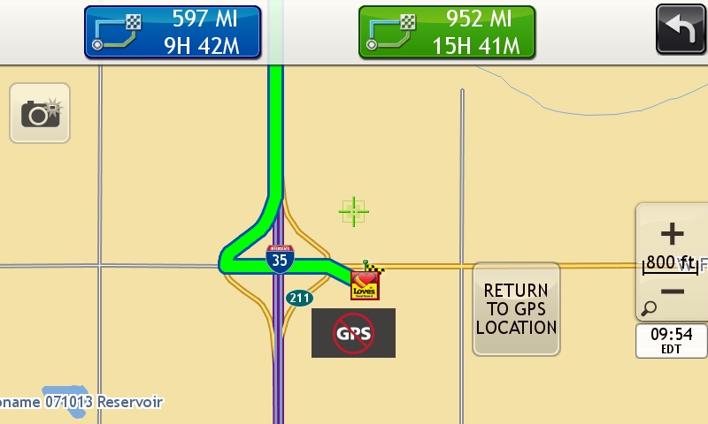

    Doesn't matter. Both routes went the lopsided, wrong way around instead of taking the exit that was 500 feet from the truck stop.
    Sheesh, how stupid do you think I am? :p
    Also, the 720 refuses to route across the bridge to the Love's (or back across the bridge to the southbound lane) in Tonkawa, OK. I was routed 8 miles south of the truck stop and expected to U-turn and drive back north to exit for Love's, then when I left in the morning, I ###### near followed the 720's directions to go north until I realized I'm heading to Texas. As soon as I hit the bridge, the route corrected itself.

    I looked at your 2nd picture wrong. My mistake. Let's not start getting personal here.
    This site does not favor any type of swearing or the indication of swearing such as misspellings of the words or hints of swearing. Let's keep the posts clean.
    This is on the latest maps.
    Shortest/Prefer Freeways.
    Shortest/Allow
    Fastest/Prefer
    Fastest/Allow
    So based upon your settings is how the router will determine the route.
    Loves - seems a false restriction was in place. This is the latest maps - not published yet.
    A trick I use is this. IF the routing is odd, then change to car mode. If it routes correctly then it is a truck restriction that is there or in error. If in car mode it still routes incorrectly then it is the maps. Either case let me know so it can be corrected.
