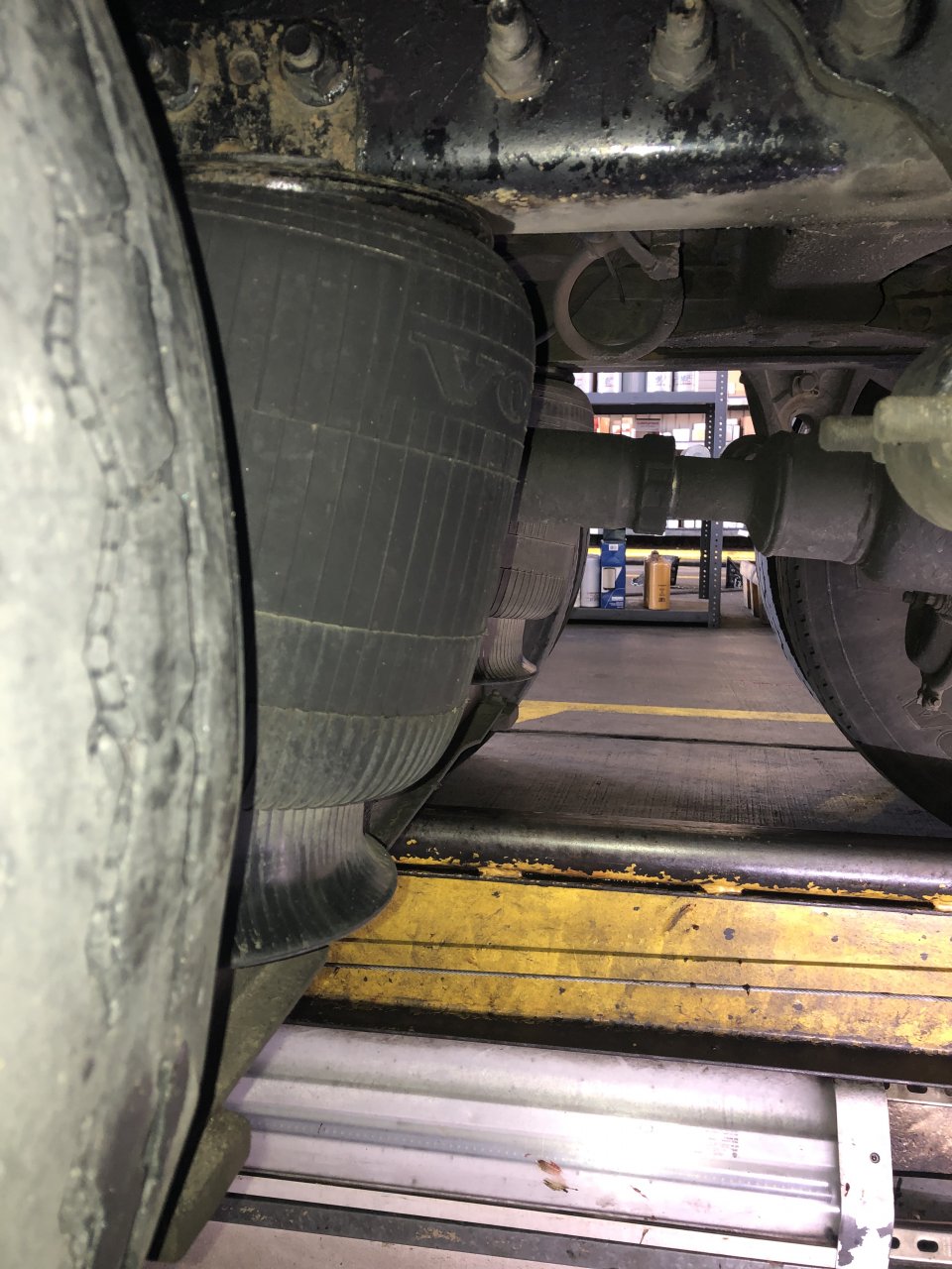

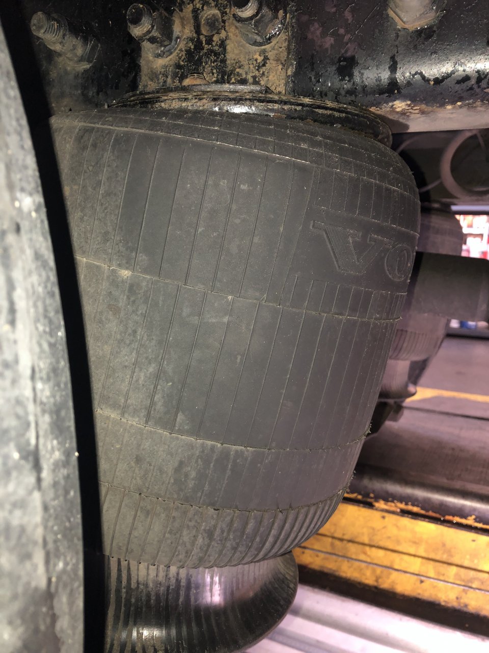

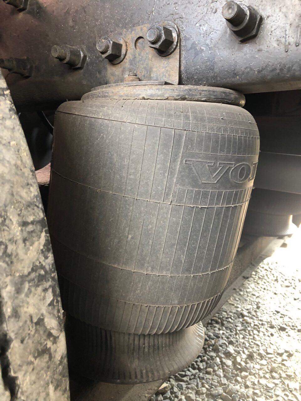

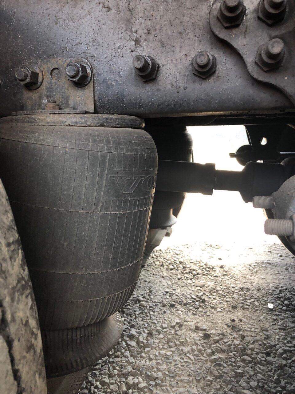

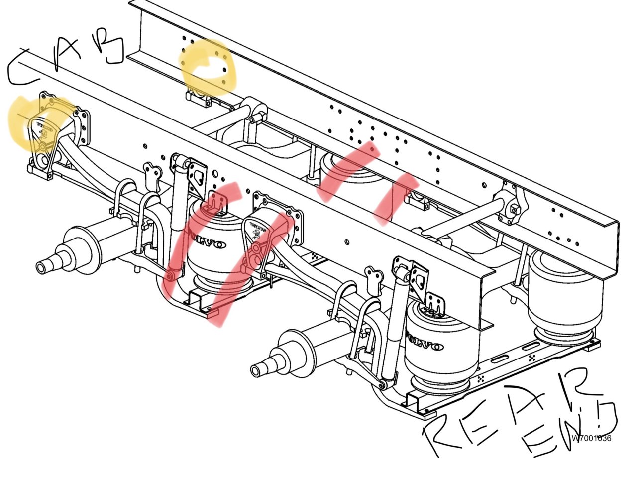

    hello, I just notice that both suspension air bags /in red on the picture/ on front drive axle are under angle. Almost 45 degree angle backwards. Something is pushing them backwards, what can be the problem? Do you have any idea where to look for the problem?
    The only thing I notice that is different are the top leaf spring /in yellow on the picture/ are sticking out in the front more than needs to be. I compare them with rear axle where everything is perfect.
    Volvo Vn64t 1999

  3. CellNet
    CellNet Light Load Member
    197
    81
    Jun 19, 2011
    Chicago IL Naples FL
    I am not sure if the plates and Ubolts are positioned correct. I have not touched anything there but seems to be replaced leaf spring before.

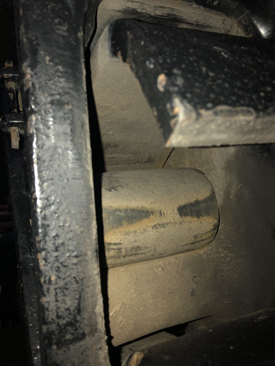

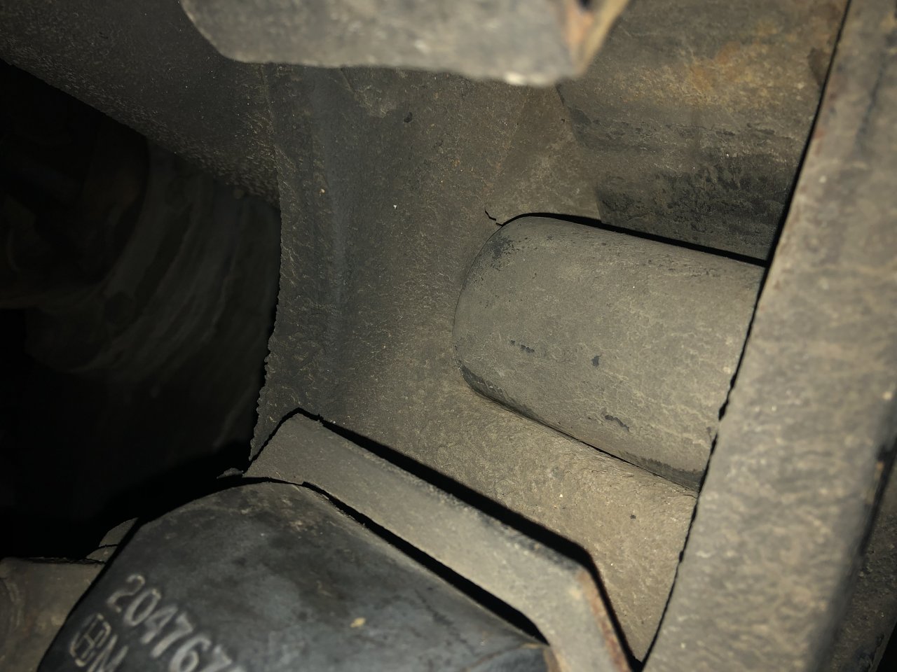

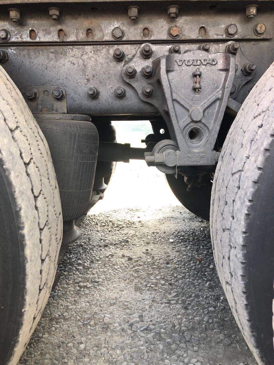

  6. CellNet
    197
    81
    Jun 19, 2011
    I understand, here go the pictures:

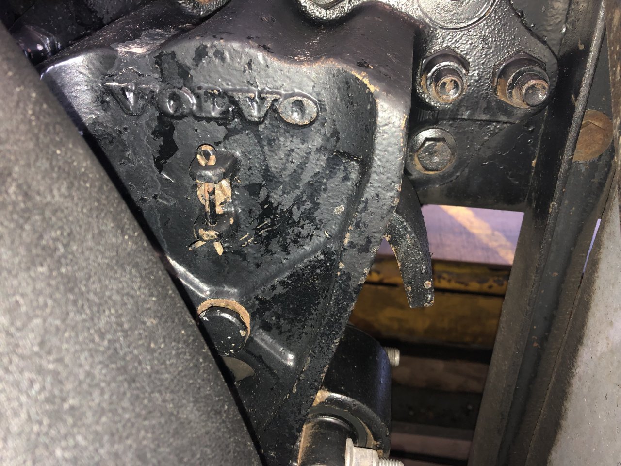

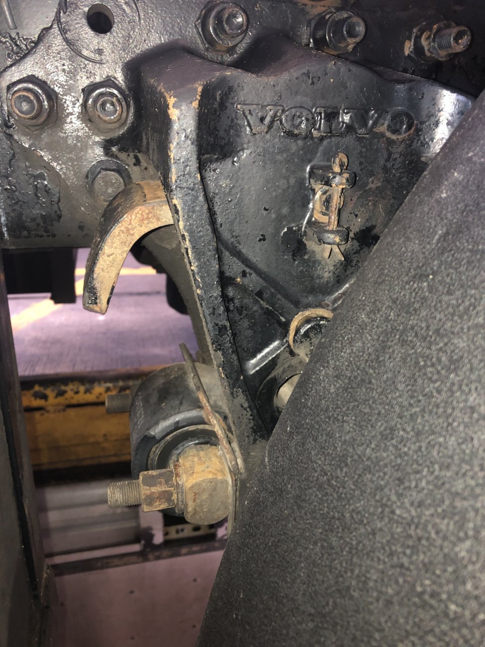

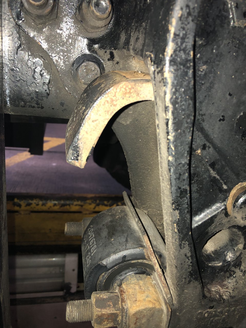

  7. daf105paccar
    5,742
    5,651
    Apr 15, 2012
    We need extra pictures from the front off the axle.
    Where the sprong connects to the chassis.
    And pictures off the spring itself.
    CellNet Thanks this.

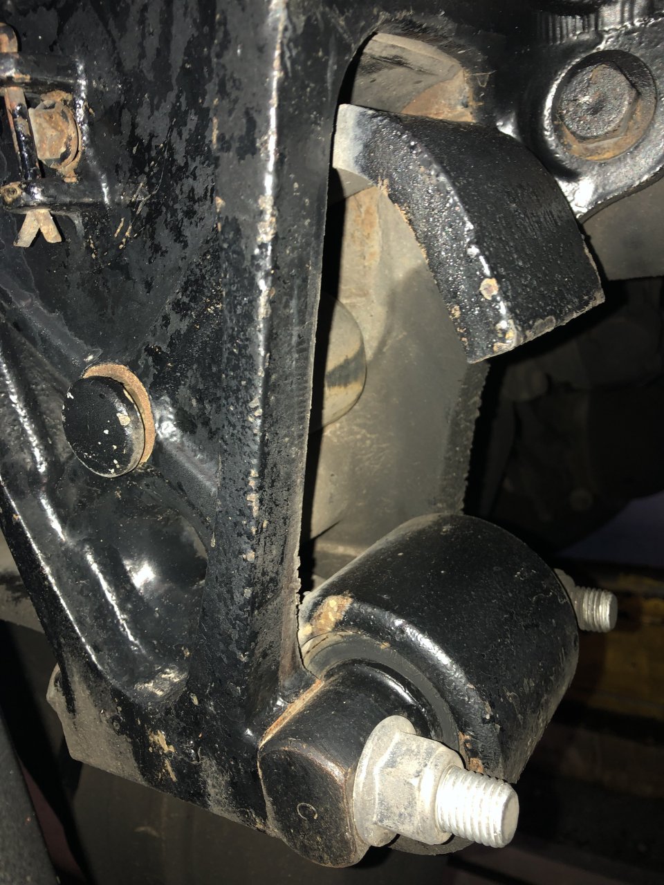

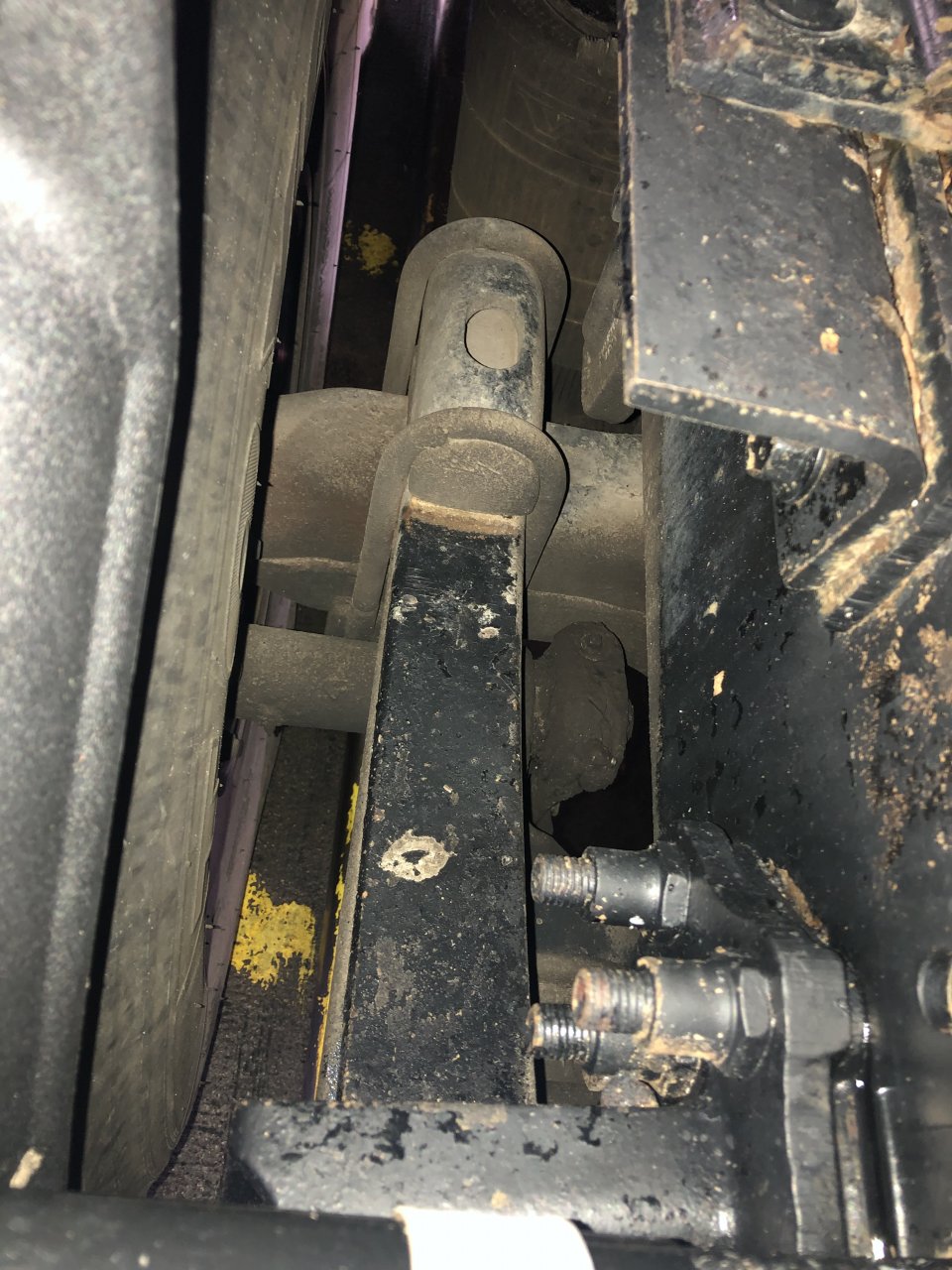

  8. CellNet
    197
    81
    Jun 19, 2011
    Here are:

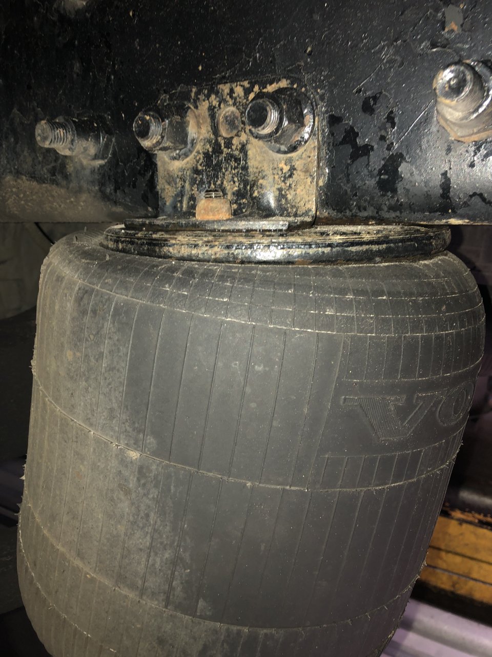

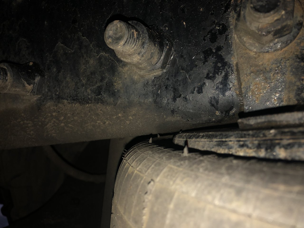

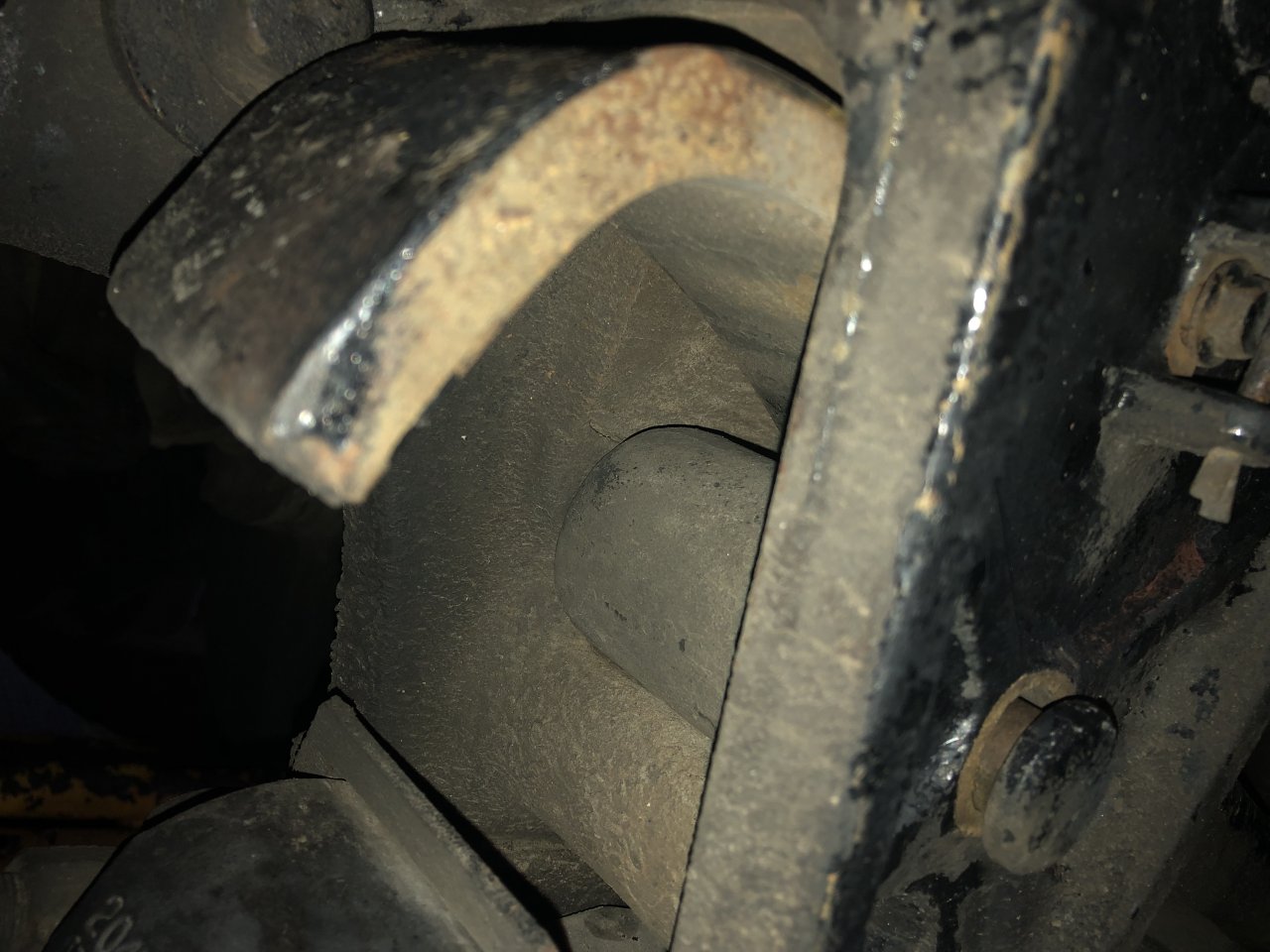

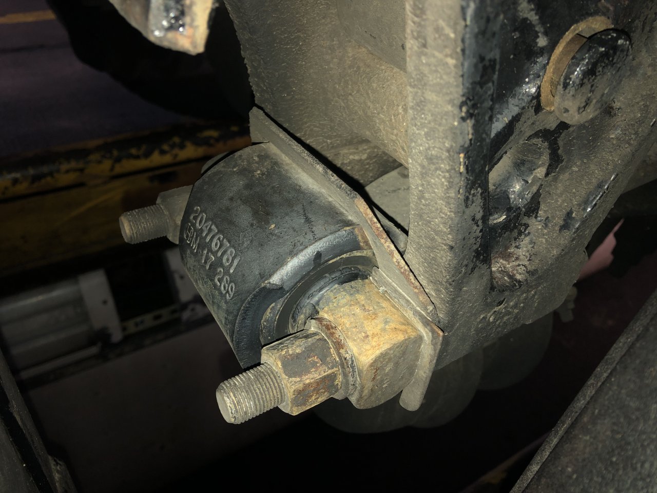

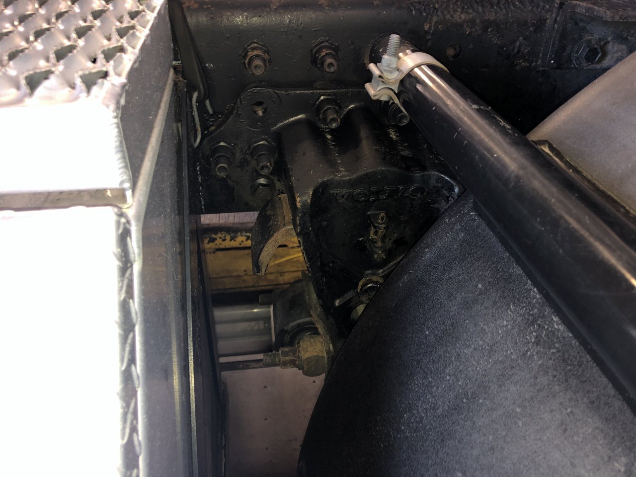

  9. CellNet
    197
    81
    Jun 19, 2011
    Some more:
  10. ibcalm19
    ibcalm19 Medium Load Member
    618
    729
    Nov 30, 2015
    Pennsylvania
    Replace your leaf springs both sides that should correct your problems.
    KB3MMX and CellNet Thank this.
  11. CellNet
    197
    81
    Jun 19, 2011
    There are two leaf springs on each side - one short and one Z shaped? Which one you think is bad? What makes you think the leaf springs are the problem?
    I have checked with volvo dealer and they have them in stock on reasonable price, but I would like to be sure that is the real problem no only trowing money on keep on replacing parts!
