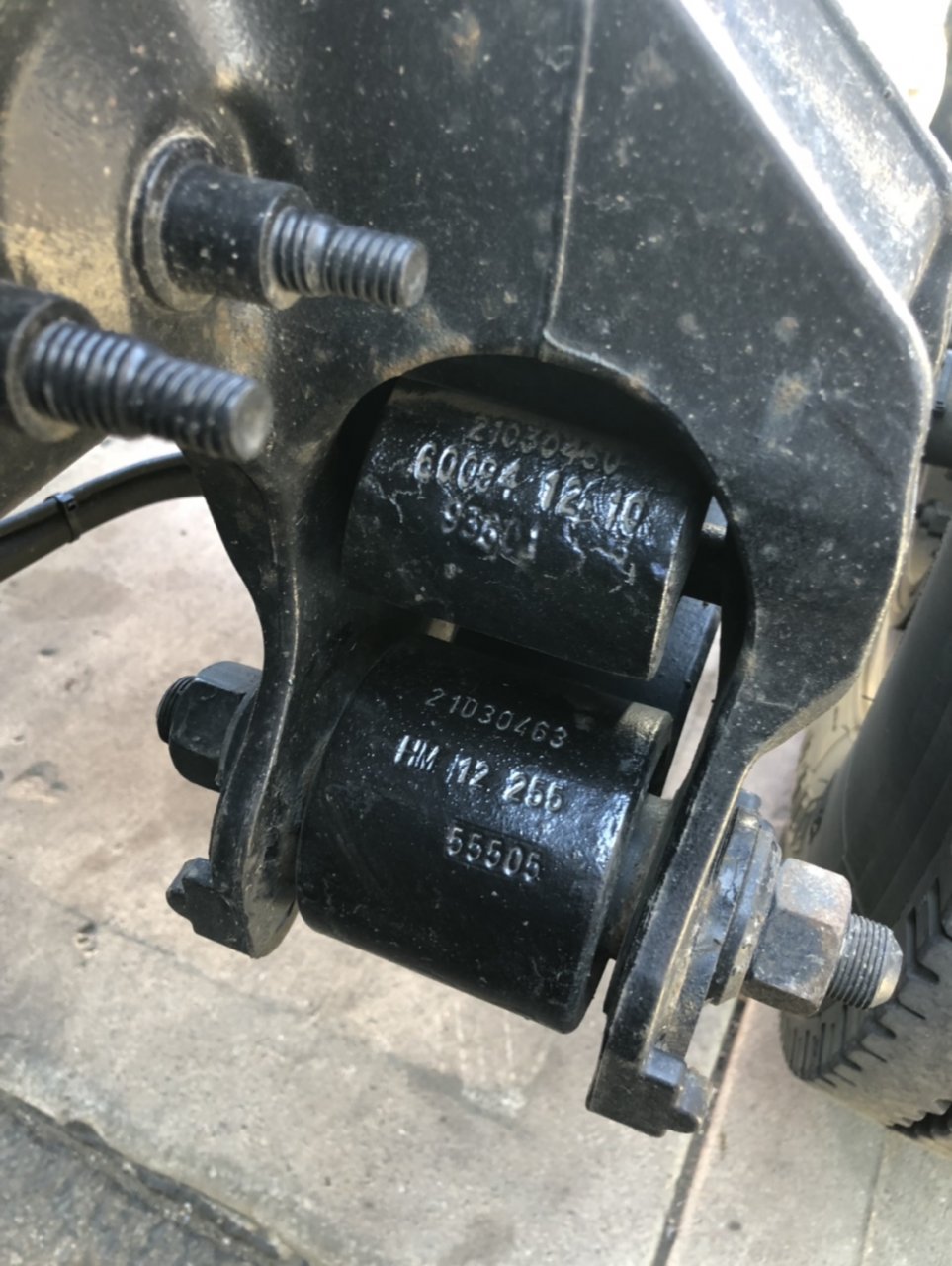

    I called the volvo dealer and checked. On all of the leaf springs part numbers matched as the dealer said. That was my first tought - wrong parts.

    Yes, it does look same on both sides. Only on the front drive axle. U bolts are tight. I dont understand which bolt has a play? on which picture you see that?

    That was the problem. I did replace the short leaf spring and installed new center pins. Everything is perfect right now. Thank you all for the help.
