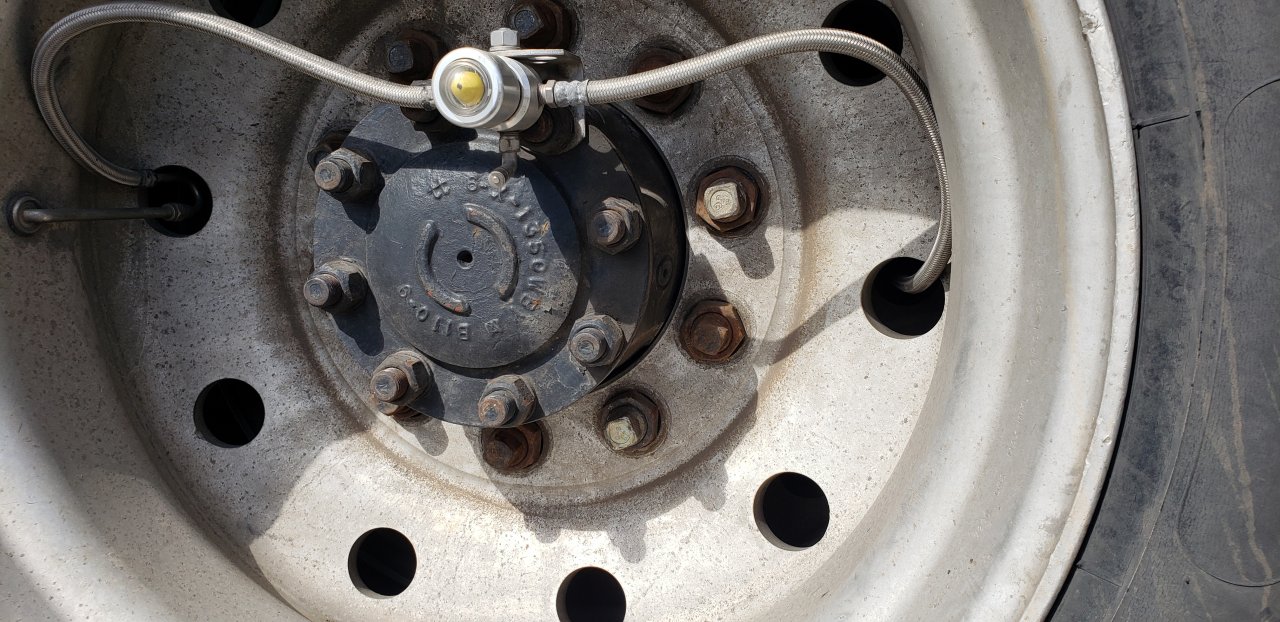

    Here's mine. International claims based on VIN that it came with hubcentric, and someone must've converted it to stud pilot.

    My first truck was an 83. We have three now of which the newest is a 2000, and all are stud piloted and aluminum wheels. Recently I put brakes on our lowboy, which is hub piloted. It took an abusive amount of effort to get those #### things off.
    Between centering problems and getting the wheels off the hubs I think I prefer to stick to stud piloted. A bit of anti-seize, a pork chop, and inner nut remover and we get by just fine. Granted, we stay relatively local, so buying wheels on the road has not been a problem.

    I wouldn't bother at this point changing, but if I had 2 identical trucks, one with hub and the other with stud piloted, I'd choose stud piloted for that reason.
