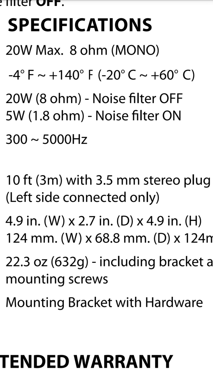

    I'll look into the Stryker. On a unrelated note.Just plugged up an old Logitech PC speaker to my Cobra and I can't tell the difference between it and the heavy duty Wilson speaker. Needless to say. Im about to brave the cold and return this dang thing.

    Most likely the only diff is the ohm rateing on the two speakers...Both should be either 4 or 8 ohm but i dont remember which..Only problem is power draw and that will only be slight..

    8 ohm is best
