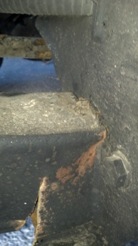

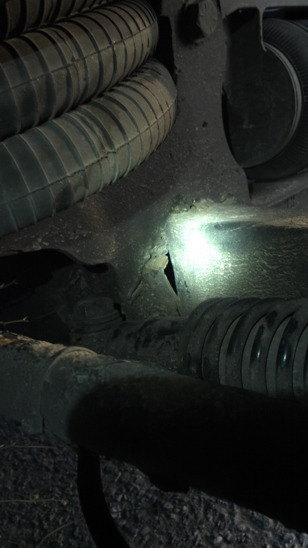

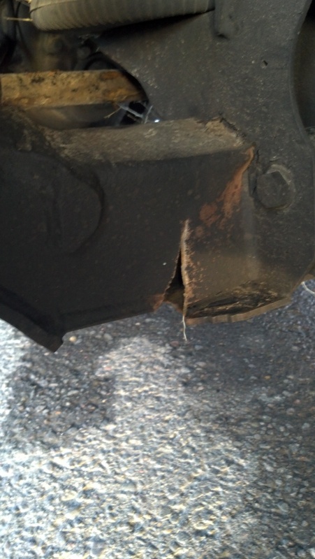

    You really need to be careful and have it checked out. I had to dig around and find some pics from a unit with a sporatic issue. Turned out the vibration did more damage than the driver had thought. We had a complete wheel end almost come off on I-5 in Seattle. 2012-02-27_07-41-09_272.jpg 2012-02-27_07-41-30_779.jpg 2012-02-27_07-43-56_966.jpg
    Have seen 3 of these fail in the last few years.
    Y2K Thanks this.
