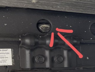

    I’ve got dash cam of me moving against the pins; I even felt the rear buck up a bit. I could go back over there and try again? Is it possible to apply too much force when sliding tandems? This is a first for me.

    Were you going backwards. Forward would only apply more force. I definitely think you can get them to pop out.

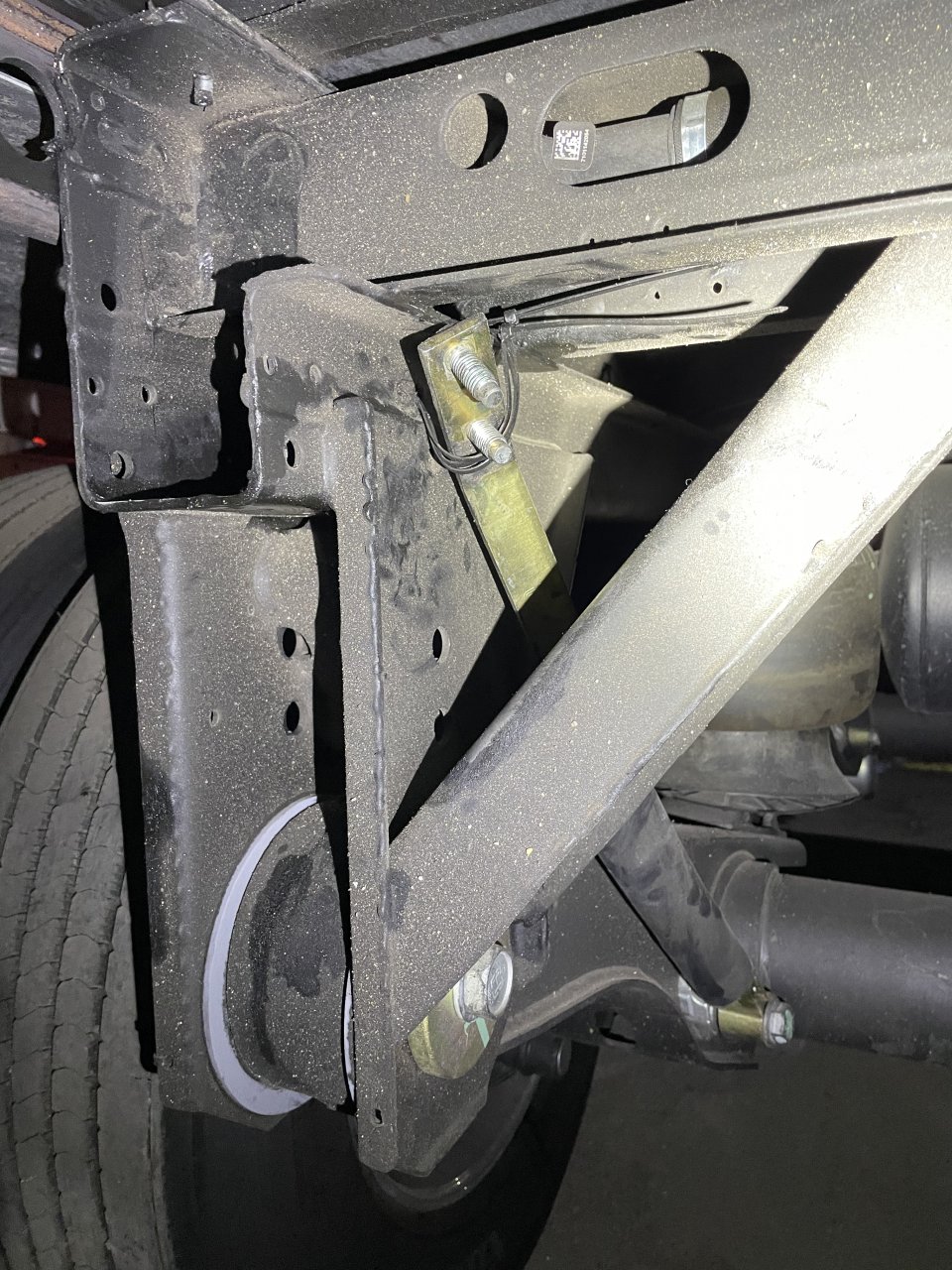

    Here you can see the slider rail pinching the pin. 6A55397F-4D1D-4059-ADC2-C7980884064B.jpeg.jpg

  5. Big Road Skateboard
    6,473
    36,242
    May 2, 2021
    Get the railoff that pin and I'd bet it pops out.

    My Trailer would do that. 1 pin would be close, the other further off from the hole. The pins are quite smaller than the holes, more than other Trailers set ups. What I’d do, to get them lined up, is back up, at an angle, to twist the tandem set into alignment. Which way to angle the TT, depends on which side is too far away. If Drivers side is further from hole turn wheel clockwise to get the angle, passengers side, counter clockwise, just enough to get an angle on TT, then set trailer brakes and back Truck up. I always get it rolling, slow, then Jack it a bit, push clutch in, and hit the trailer hand brake. That shifts the tandem set on the rails, so pins will both line up. Hope that makes sense. Don’t worry about backing it up too hard to make them slide. If your loaded heavy, it can take quite of force.

    Tech said the passenger side pin had somehow come out of alignment; unbolting that shiny piece did something; my company said it was fine to roll on it.
