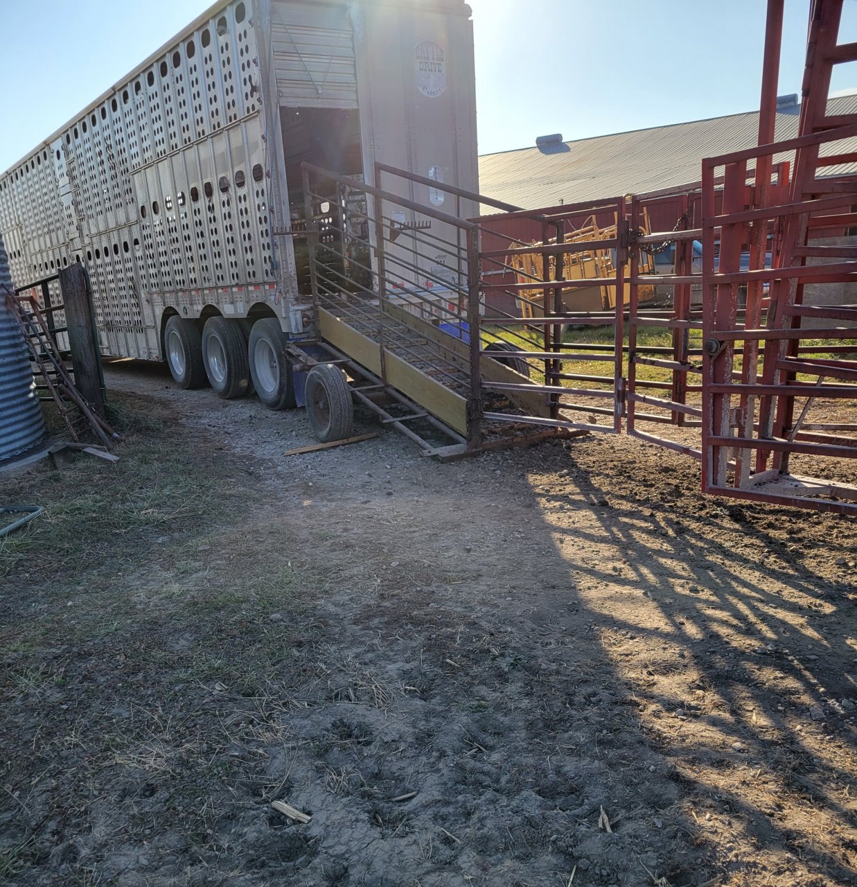

    Everything in this thread has been basic.
    I quibbled with him. When making "normal" turns, having the 5th wheel forward does shorten the vehicle. However when making a u turn, having the 5th wheel back allows a tighter radius. I think it's a difference of less the 3 feet, so if you're in that kind of position, ya dun messed up several decisions ago.

    It can be - just nail a 6 inch board perpendicular at the 10 foot mark to simulate the tandems. You'll since the drag marks of both the "tandems" and the tail.

    Bill pretty much explains it.
    Think about that view from above. A 5th wheel centered above the drives means the kingpin moves with the tandem. But if the 5th wheel is forward of the tandem, the rotation of the tractor moves the kingpin towards the inside of the turn sooner. One would think this means more off-tracking, but because the 5th wheel is forward of the tandem, the kingpin follows a longer arc than the tandem, effectively reducing off-track. That's why I said I thought moving the 5th with the intent of changing the cornering behavior wasn't a productive endeavor.
    A framework that sticks out behind the tandems to hold the 5th wheel.
    The tongue of my trailer and the stinger are between that blue Bronco and the drives.
    When I initiate a turn, the initial movement of the kingpin is to the outside of the turn. The truck pivots about the tandems at low speeds, so the stinger moves opposite the steer axle as the truck rotates.
