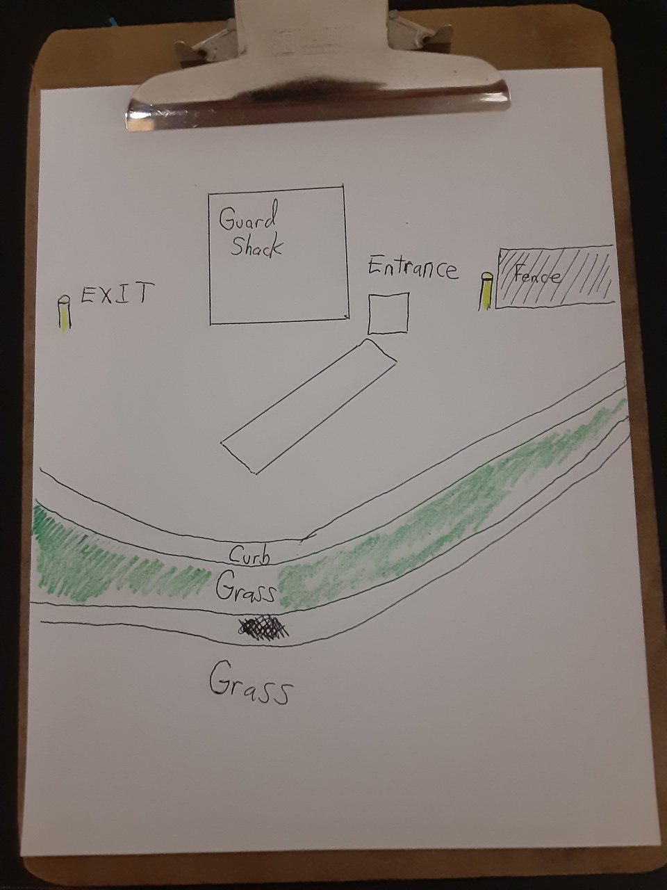

  11. MACK E-6
    50,266
    240,875
    Let me get this straight.
    You were trying to exit on the left side, do a u-turn counter clockwise, and pull back in on the right side?
    The first issue I see right off the bat, assuming the picture is to scale, is pulling straight ahead would cause your trailer to track through the guard shack.
    What I would’ve tried was to take a left out of the exit side, pull forward far enough to get straight again, back straight up, and then swing wide to your right to get back in on the entrance side.
    RockinChair and expedite_it Thank this.
