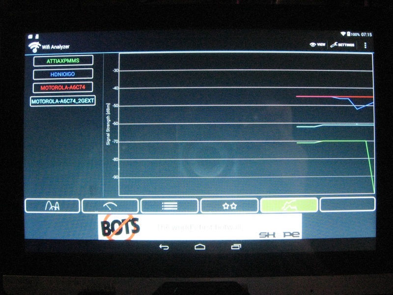

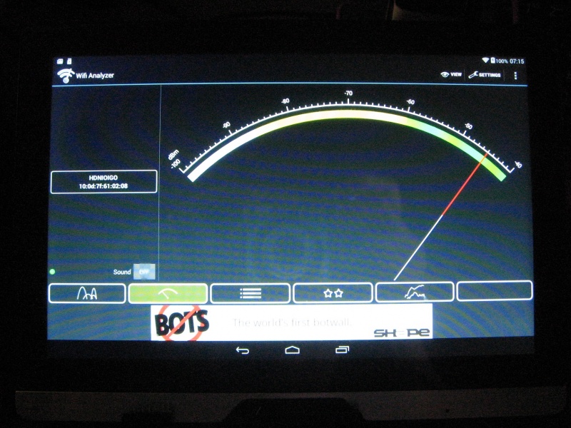

    I have my table all over the house with no issues. I suggest you download the app Wi-Fi Analyzer and see what the signal strength is on the tablet and move your phone various distances to see if indeed the signal drops. Very useful app.
