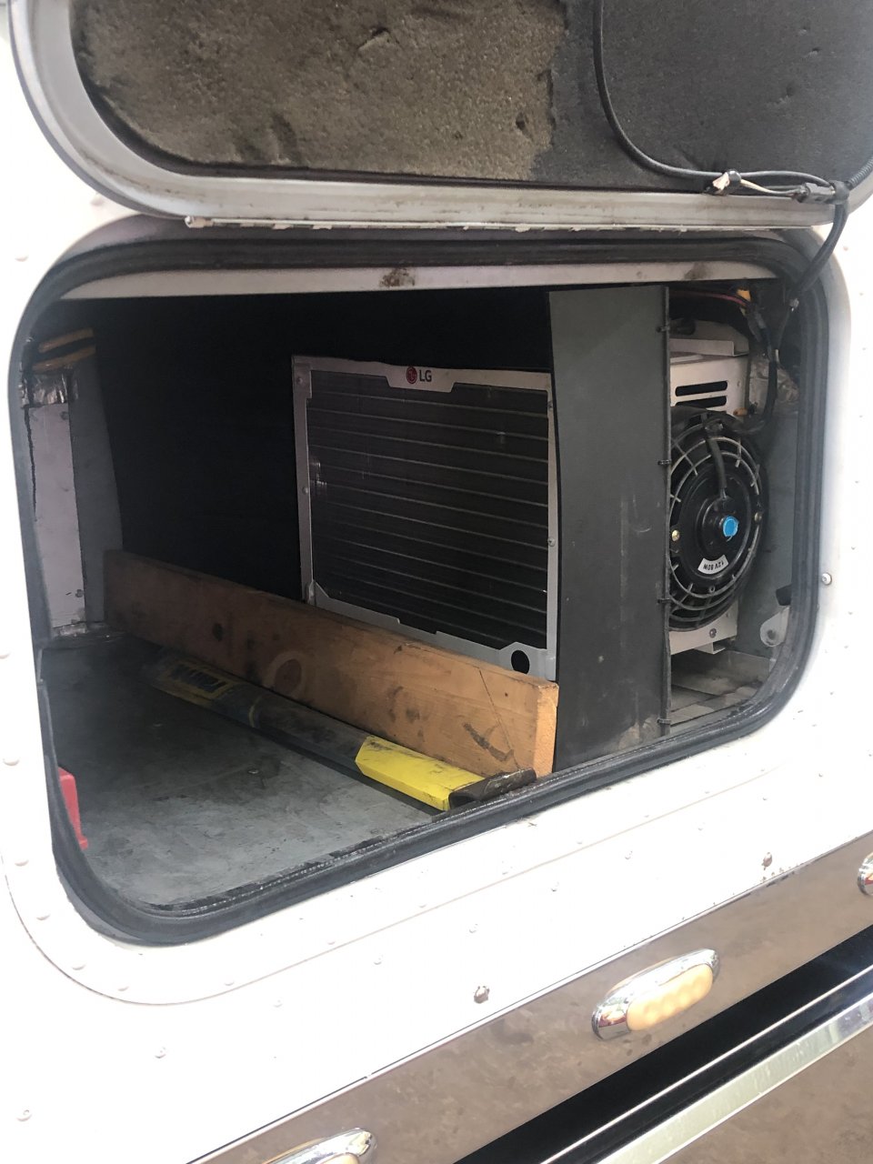

    It’s a 5k BTU unit. Just drains into the boot box. I drilled a 1/4 in hole in the floor but dosent leak much if at all.
    Worked better than the stand up 15k btu unit I had in there the 5 years prior.

    Should say that I have updated this instal to include baffles and a 8” spall fan. I’ll update with pictures later.

    Here is the updated picture. I have an rv door latch that holds the door vertical. I have a switch in the bunk for the fan. Only needs the fan if it’s really hot out. 57B2E1AD-DD2A-424B-B025-9B35AE233EE0.jpeg
    I can and do idle the truck when it’s at the extremes. But my set up is super quiet and 0 vibrations. I really don’t like laying in a idleing truck.
