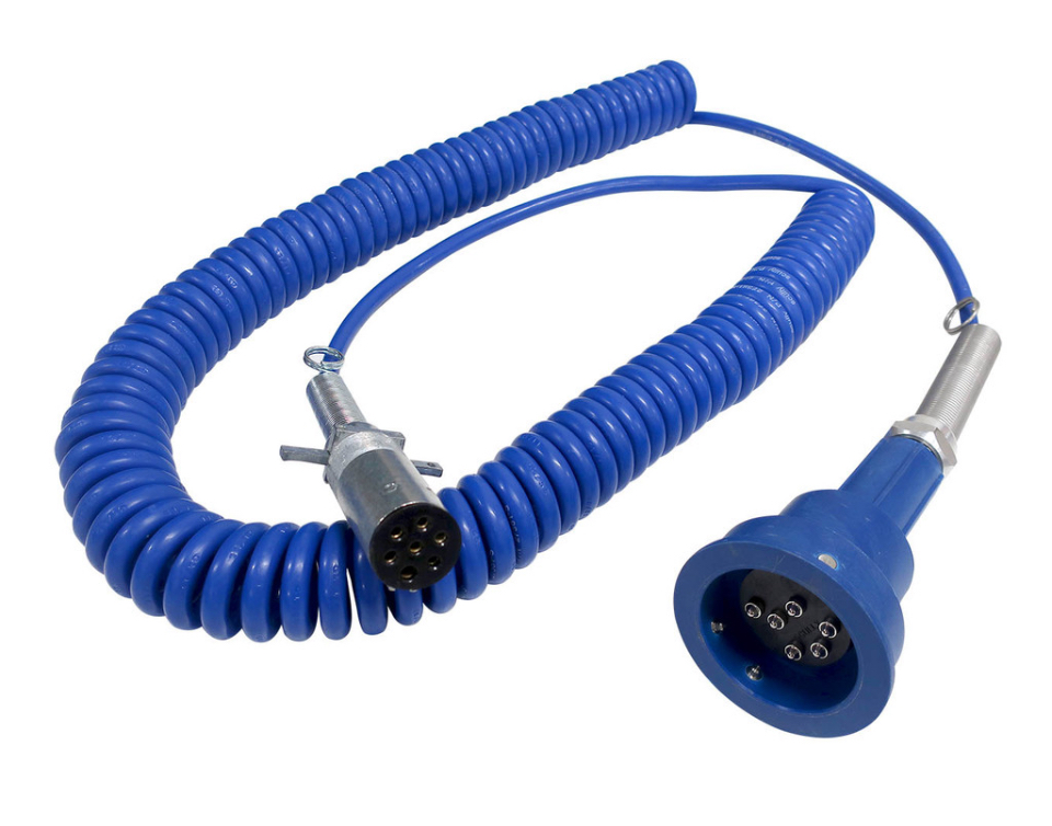

    Speaking of the scully, if the plug doesn't make good contact with the connection on your trailer, you might have to use some creative methods to hang the cord from the top of a compartment door or the bungee straps on the hose tray. I've also used an extra gasket around the socket to keep the plug on-axis and keep the upper contacts touching each other. If the contacts on the plug or socket are dirty you can clean them with a diaper dipped in gasoline or a pencil eraser.

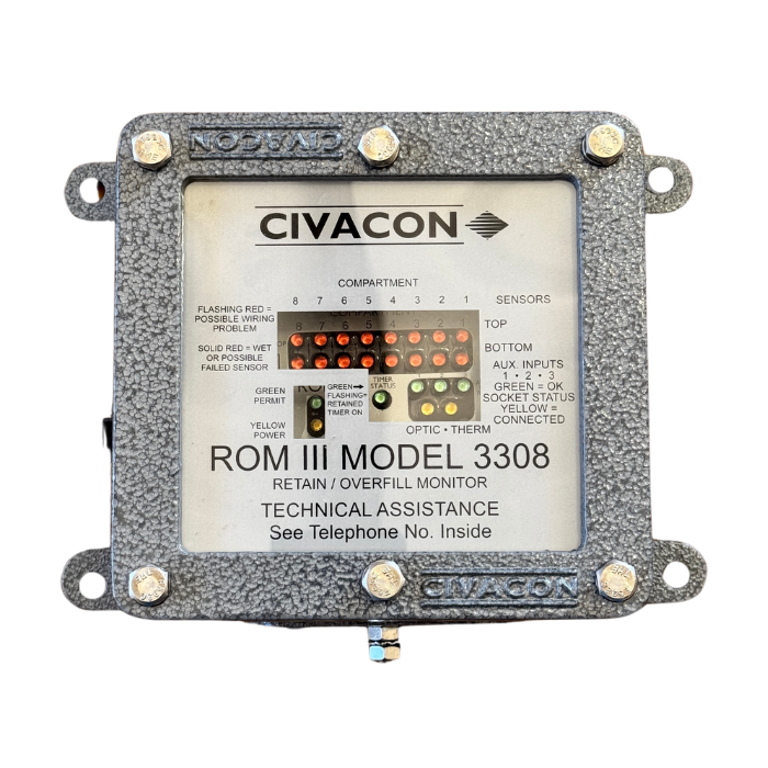

    A “Scully” is a type of cord that runs from the rack to some type of overfill/retain system on the trailer. This cord will shut down and or not allow the filling process to happen if it’s triggered by one of the “retain” or “overfill” sensors on the trailer. The scully also provides a ground source to prevent static discharge. You will learn all about these systems in your training.
