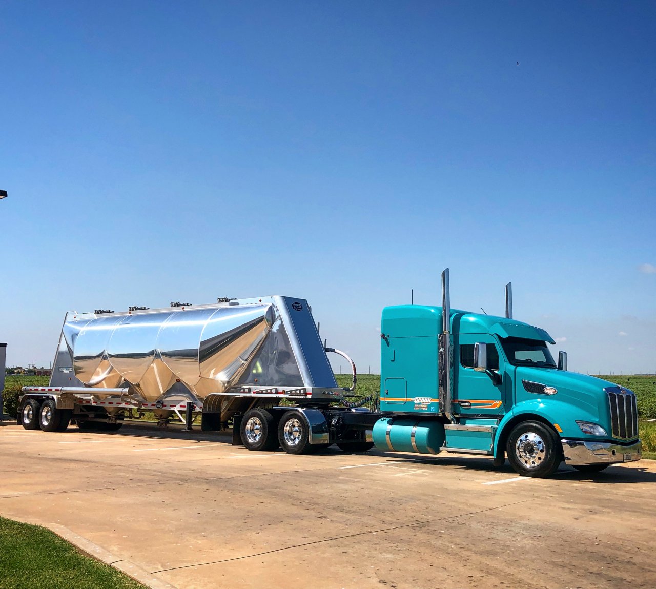

    Taking a 34 at the Hampton Inn down in Altus OK a couple weekends ago. Just taking up about 8 parking spots.
