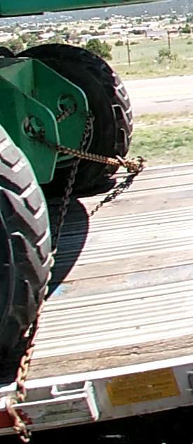

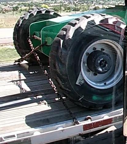

    Unless we know the weight of the unit we don't know that its an incorrect way to secure. Tho personally I'd have preferred to pull back/forward instead of straight down.

  4. johndeere4020
    8,522
    119,292
    Jan 1, 2010
    It’s as wide as the trailer and has decent size tires. It’s over 10,000.

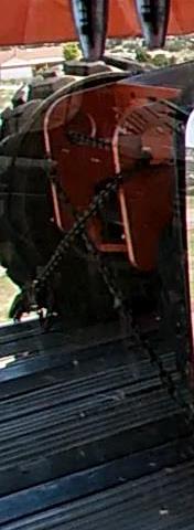

  5. Gumper
    Gumper Road Train Member
    1,579
    3,843
    Jan 7, 2018
    Butte, MT
    Easily over 10,000. They could move pretty easy with no forward or rearward pull of the chains. And who wraps the chains through the tie down points like that? Total hack job.
  6. Cattleman84
    Cattleman84 Road Train Member
    9,894
    70,470
    Nov 1, 2017
    The Sticks, Idaho
    Id have run the chain from one side straight through tie-down holes and then to other side... Use 2 binders and leave slack hang between the-down holes... 2 completely independent anchors with 1 chain.

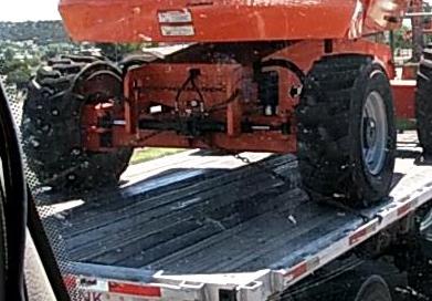

  7. spyder7723
    spyder7723 Road Train Member
    15,470
    25,061
    Mar 31, 2013
    sarasota, fl
    I can't tell what it is in the pics. Look to me like some kind of trailer
  8. mr truckdriver
    mr truckdriver Light Load Member
    286
    178
    Mar 2, 2008
    ft myers fl
    It's a man lift probably around 15,000 lbs give or take

  9. johndeere4020
    8,522
    119,292
    Jan 1, 2010
    It’s a boomlift, a 40’ boomlift which is small is over 15,000.
  10. spyder7723
    15,470
    25,061
    Mar 31, 2013
    sarasota, fl
    We'll ya in that case 4 point attachment is needed.
