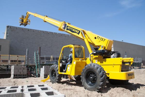

    Load the bunk on the trailer, drive to pole yard. (Load on drom if it's a pole yard that isn't local. ) Pull into yard, drop trailer, break out the long tape measure and pull forward. Blocks are placed in the fifth wheel to lock it (and the bunk) into position. Guy in Pettibone puts the bunk into the fifth wheel. Poles are loaded, everything is tied down. A chain goes from the bunk to the trailer kingpin, lights and air hose extensions are suspended from that. Raise the landing gear, tighten everything back up. Lights, flags, banners as needed, and head out.

  11. Lepton1
    Lepton1 Road Train Member
    12,647
    25,588
    Nov 23, 2012
    Yukon, OK
    Something struck me about your post.
    You used the term "Pettibone". This is sometimes referred to as simply "The Bone". Folks in the oil industry didn't know what I was talking about, yet "The Bone" is the workhorse of any oil rig or construction site.
    Happiness is a good Bone operator for an open deck driver.
    Pettibone was the first to invent the ingenious overhead forklift that can extend the forks. I have been loaded or offloaded with many a Bone. It's amazing what they can do.
    jamespmack, cke, Oxbow and 7 others Thank this.
