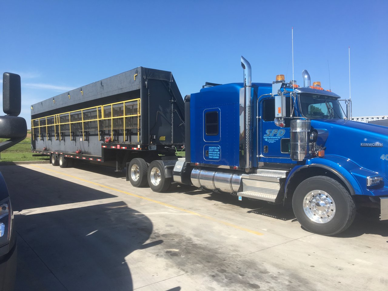

    We pull some power only trailers that are very lopsided in weight and therefore have a leveling valve on each side. I believe they use Hendrickson brand leveling valves that have a bit of a “dead spot” in the middle where they won’t add or subtract air for a few degrees of the travel.
