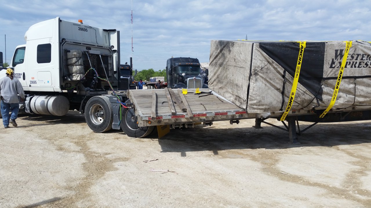

    WTF is that? I'm seeing lines hooked up but looks like he's trying to get under with the 5th wheel..
    No comprende senor
    And the legs are still up...

    Looks to me like he dropped it, either from a bad hookup or somebody unlatched his fifth wheel.

    Definitely a moving drop during a turn. You can see how torqued the landing gear is, and a short skid mark behind the pad its on. The neck fell onto the frame and tried to fall off the driver side but is tangled up in the tire. And the load is shifted from it.
    Even western express doesnt miss the pin by 6ft.

    Ok. But I still don't understand how the trailer came apart during the turn? Is this operator error, mechanical defects, something overlooked?
