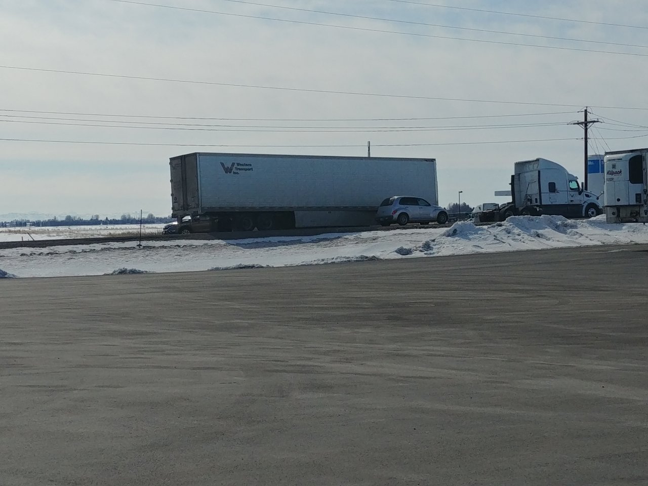

    Most times, if you high hook a trailer you will be able to see a gap between the 5th wheel and the trailer apron... At least big enough to put you finger in. FYI... DONT PUT YOUR FINGER IN THE GAP!!!
    Most dropped trailers I've seen have been the result of the 5th wheel jaws NOT fully locking. This can be particularly easy to do in the winter when the grease in the jaw mechanism is very cold. Or even more common... The driver didnt clean the snow and ice out of the jaws and off the 5th wheel before coupling a trailer. Heres a pic of a trailer that got dropped that I witnessed. Driver made it clear out from the back of the yard and a couple hundred feet down the road before it dropped. It was about 10° outside.
