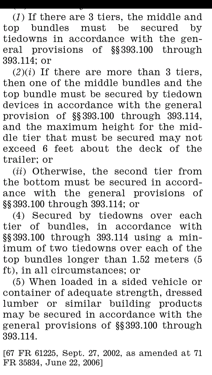

    They will have a hard time producing that regulation, there is not one for general cargo. That being said, belly straps may not be required but that should be used.
    That’s a weird looking load of dressed lumber. Cargo specific regulations only apply to their respective cargos.

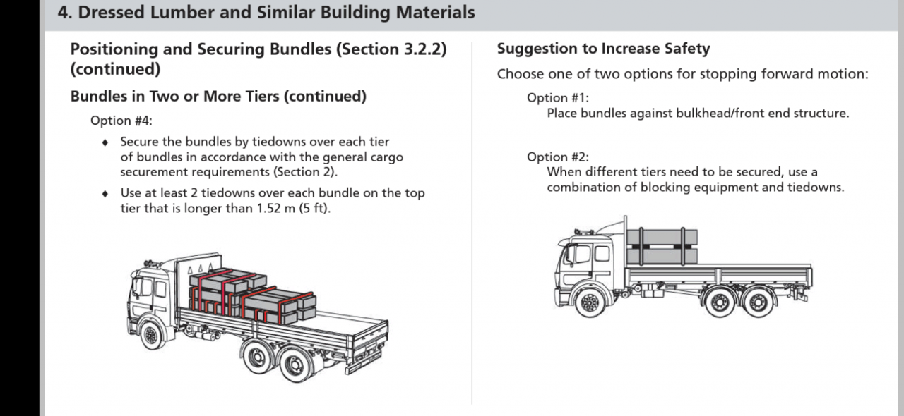

    I don't think it's a load of dressed lumber.
    But I couldn't find anything in the DOT handbook for that type of product and that regulation said "dressed lumber and other materials of similar shape."
    Not trying to be snarky but what cargo securement rule would apply?

    The general cargo securement rules would apply. 393.100-393.115
    the regulations do not say “dressed lumber and other materials of similar shape”.
    Here is the actual regulation:
    393.118 What are the rules for securing dressed lumber or similar building products?
    (a) Applicability. The rules in this section apply to the transportation of bundles of dressed lumber, packaged lumber, building products such as plywood, gypsum board or other materials of similar shape. Lumber or building products which are not bundled or packaged must be treated as loose items and transported in accordance with §§393.100 through 393.114 of this subpart. For the purpose of this section, “bundle” refers to packages of lumber, building materials or similar products which are unitized for securement as a single article of cargo.

    I shortened it a bit but it does say "or other materials of similar shape"
    cke and PoleCrusher Thank this.
