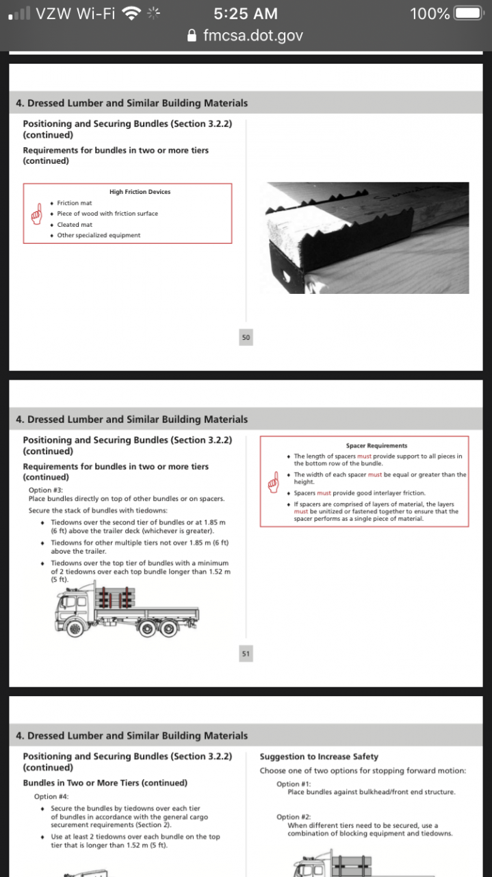

    Whats the one about units stacked over 6’ high need one per layer?

    I’ve looked many times in the regulations. Outside of the dressed lumber regulations, I’ve never seen anything like that. I would be happy if someone proved me wrong, that way I can stop spreading incorrect information. I am stubborn and from the Sho-me-state after all!

    it is in the dressed lumber and similar building materials section/
    Idk the defining measure of whats similar as far as building materials.
    Seems like if you got units stacked 3 high, be a better idea to secure layers underneath the top layer vs strictly over the top.
    i can give a real good example of how layered securement would be of benefit vs over the top; but its longer than im about to type out at the moment, what with my coffee being down the hall and my day needing to get started.

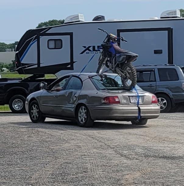

    Here’s some securement ……

    Congratulations on not busting out the rear window I guess.

    That's Wrong..Everyone Knows that Front Wheel should be turned to the Left..
