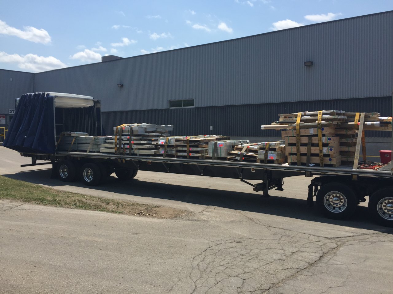

    Not going to lie, I usually way over strap. Here is my last load before it was tarped.
    Edit, that load weighed right under 40k.

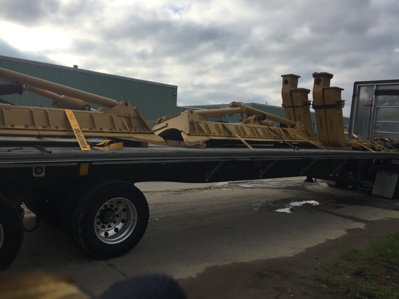

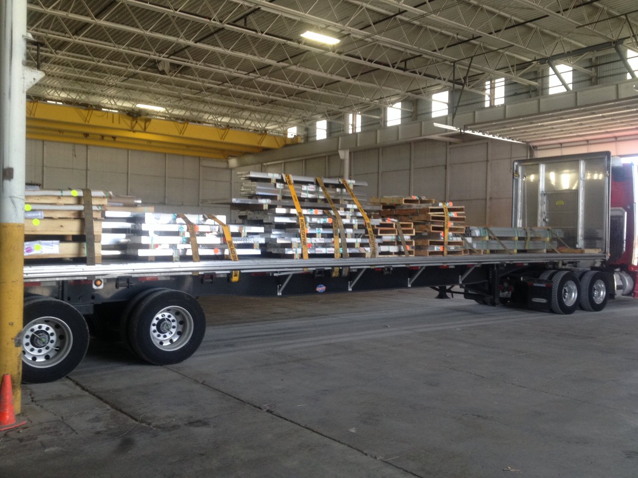

    EVERY layer? You must be a patient man!
    B996D925-3286-4603-8757-14A2649B123B.jpeg 3A84F022-8E6E-4C92-9C5E-F9B70C581429.jpeg
