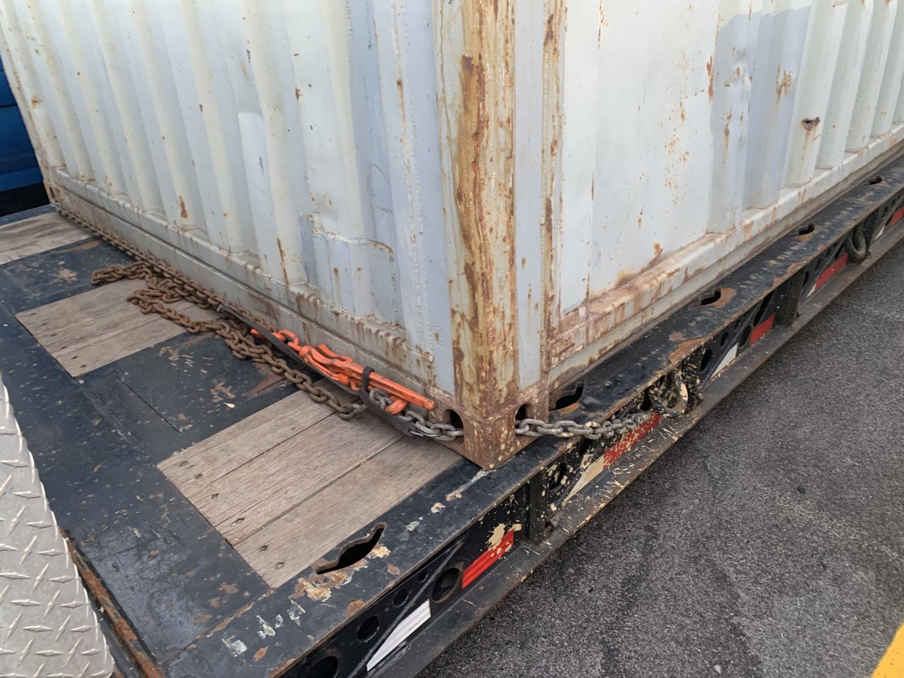

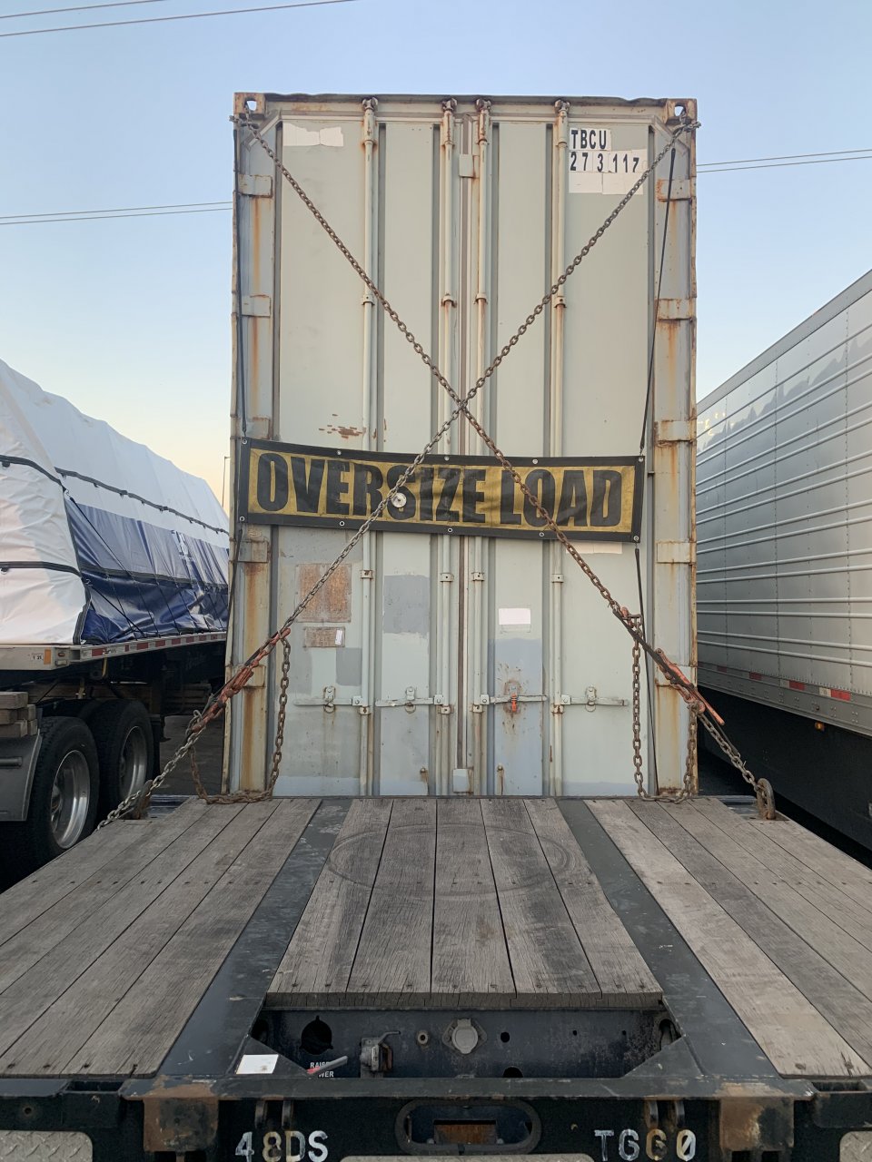

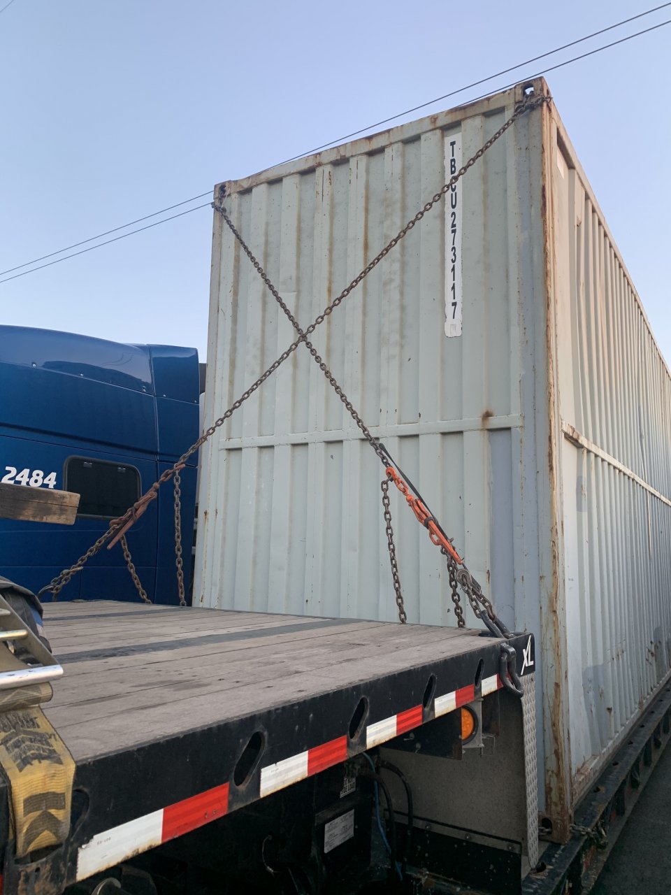

    I’ve never had one move with cross chains front and back and horseshoe chains around the bottom. Some of the other guys don’t wanna climb up and put the chains on top and just do the horseshoes and straps over the top. While that’s legal A few of them Have had containers move
    , mine never have. 86F495BD-675D-4E63-B904-28AAE8D106CE.jpeg 4A664C9A-AECE-466E-89EC-A5369C18EA01.jpeg F9C04241-5B88-4DB3-8C9E-F14FA116A53D.jpeg
    W923, D.Tibbitt, cke and 13 others Thank this.
