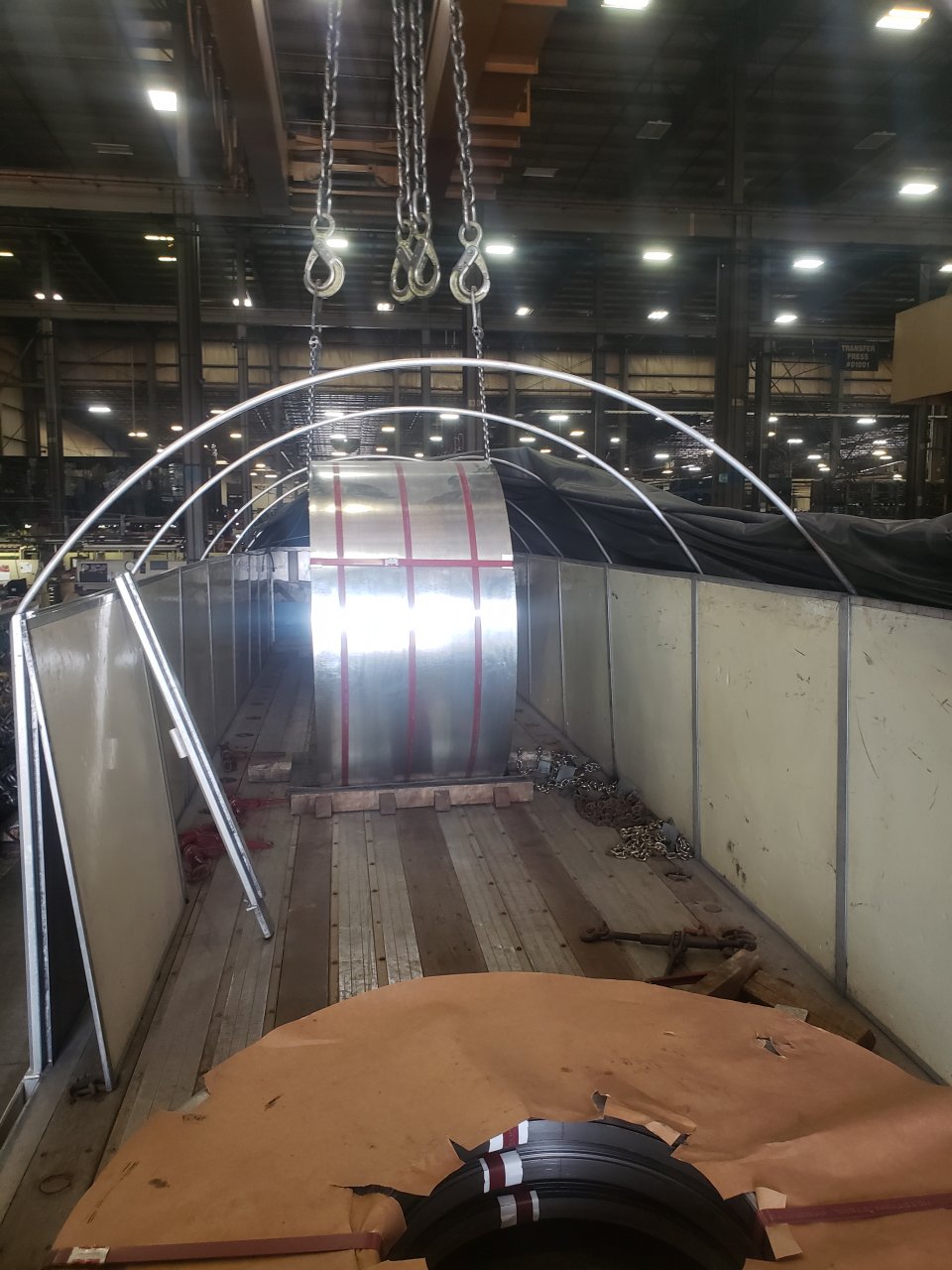

    How are you dealing with suicided, big coils with pop-ups? I pulled an East covered wagon set up just like your trailer. There’s no way to get proper securement on anything over 48”. I regularly hauled 7’ and 8’ wide coils to a pipe manufacturer who used a giant forklift to pluck them off. With pop-ups, I was limited to how I could chain them. I had no choice but to leave the sideboards pulled and spread out my chains along the rub rail.
    I never used a trip chain on shotgun coils. However, I always did on skidded coils. I always made a bulkhead for any type of bar stock.
    Someone mentioned timbers being inside the frame rails. There are coil racks made to put the timbers right on the rails. They require an 8”X8” timber. Perfect for big singles. I’m pretty sure that tarp shop off I-270, Exit 3, in Granite City, is where that employer got them.

    Tri city canvas used to sell them. That’s all they had when we needed some coil racks once, we don’t generally haul coils. I used them once and then drug them heavy sob’s from one end of that trailer to the other 100 times before I left them at the yard. They were always in the #### way. F5805D4B-1FE4-4680-8E67-790894E71ABE.jpeg

    I’d flip the racks over the tractor’s frame rails, put the timbers on top, then, ratchet strap everything down. I hated to leave them behind, when I moved on. I never felt safe with big singles in small racks, after using them.

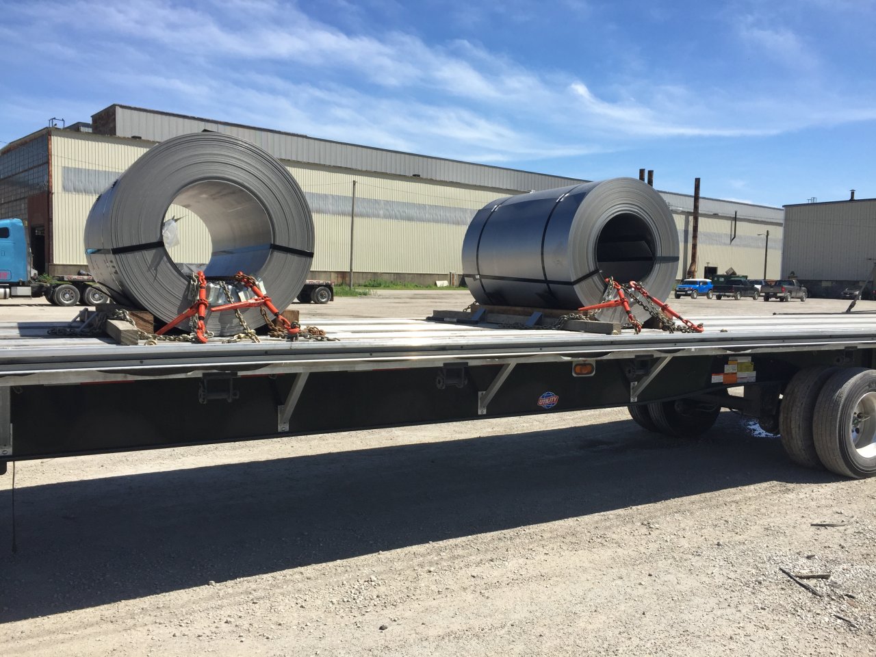

    Was this from the video, or your loading? The tarp job looks better than the one you first showed, and that securement is definitely suspect, although legal. :(
    I always did mine different, legal and redundant. Horse shoe chain on each side, to keep the side to side limited and the telescoping in check. This is from a load headed for Carson City, CA years ago.
    First, Horshoe, as close to the center of the coil as possible, chain is edge protected on each of the 4 edges (yes it's a pain) binder one side.
    Then the next is an X chain, which is my specialty Hybrid X/Horshoe. It helps telescoping and tightens the closure around the coil. Edge protect 4 sides also binder on opposite side of Horshoe chain binder.
    This is how it looks from the inside:
    And a little closer for a better view:
    As you can tell, using those edge protectors that way, took a while and it was getting late so the next pictures are outside in the dark where I had to finish.
    And from the inside with the second X:
    And the next morning because I had to sleep over :)
    Later, enroute, I had to take a 34, so I was able to take a few daylight shots to show the chains better.
    Normally, the above chain would have been further back, further stopping telescoping, movement and minimizing slop for the coil to begin momentum, which is what securement is all about. Stopping movement turning into momentum. :) The strap, as you can see though, is where the chain would have gone around the spool, and I didn't want to chance damaging the strap. Steel trailer, I have no qualms about chaining a pocket...aluminum not so much. 5 chains, 3 straps. 33.4k securement, for I think it was 42k coil.
