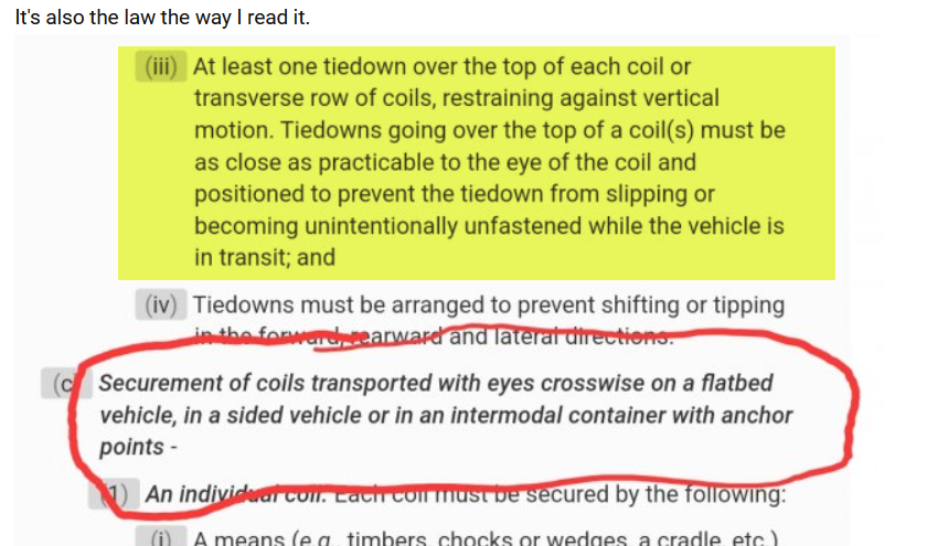

    If you are reading what I highlighted, that is from the previous section for carrying coils with the eyes facing up, i.e. the coils laying flat.
