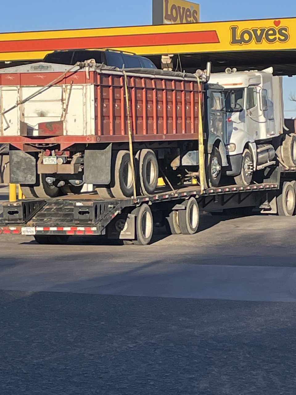

    Look at this sweet pic I snapped an hour ago lol.

    At first I was thinking the straps were holding the box down then I saw the Suburban in the back.

    I hope you're not a trainer.

    I see chains holding the trucks down and it appears that the straps are only to secure the tarp.
    No idea about the Suburban.

    Maybe the shipper wanted the rolled roofing to stayed vented like a onion load? Possibly someone stole his bungee's? IDK. I couldn't roll down the interstate with a tarp flapping/ballooning like that, It would drive me nuts.

    Looks like he's only using one steel tarp. Wonder what that strap is holding down? :)
    Maybe it was supposed to hold down the back of the tarp, but failed as the air started popping it up.
