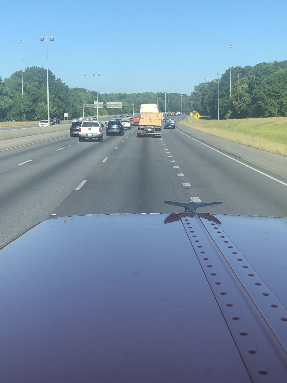

    Started singing this song when I saw this flatbed load
    “Lean on me
    When you're not strong
    And I'll be your friend
