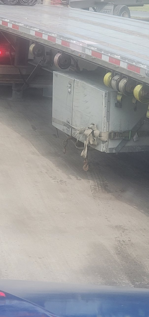

    High quality carrier here.
    A reminder to not store chains and binders in your sideboxes, and if you must, to properly reinforce the box.
    That strap is the wrong orientation for what hes trying to acheive.
  8. Kshaw0960
    Kshaw0960 Road Train Member
    1,581
    5,023
    Jun 17, 2018
    I’ve had the bottom blow out on my trailer box with under 50 lbs in it. Now I always buy a 2” 4 ft L channel from Home Depot and reinforce the corners.
