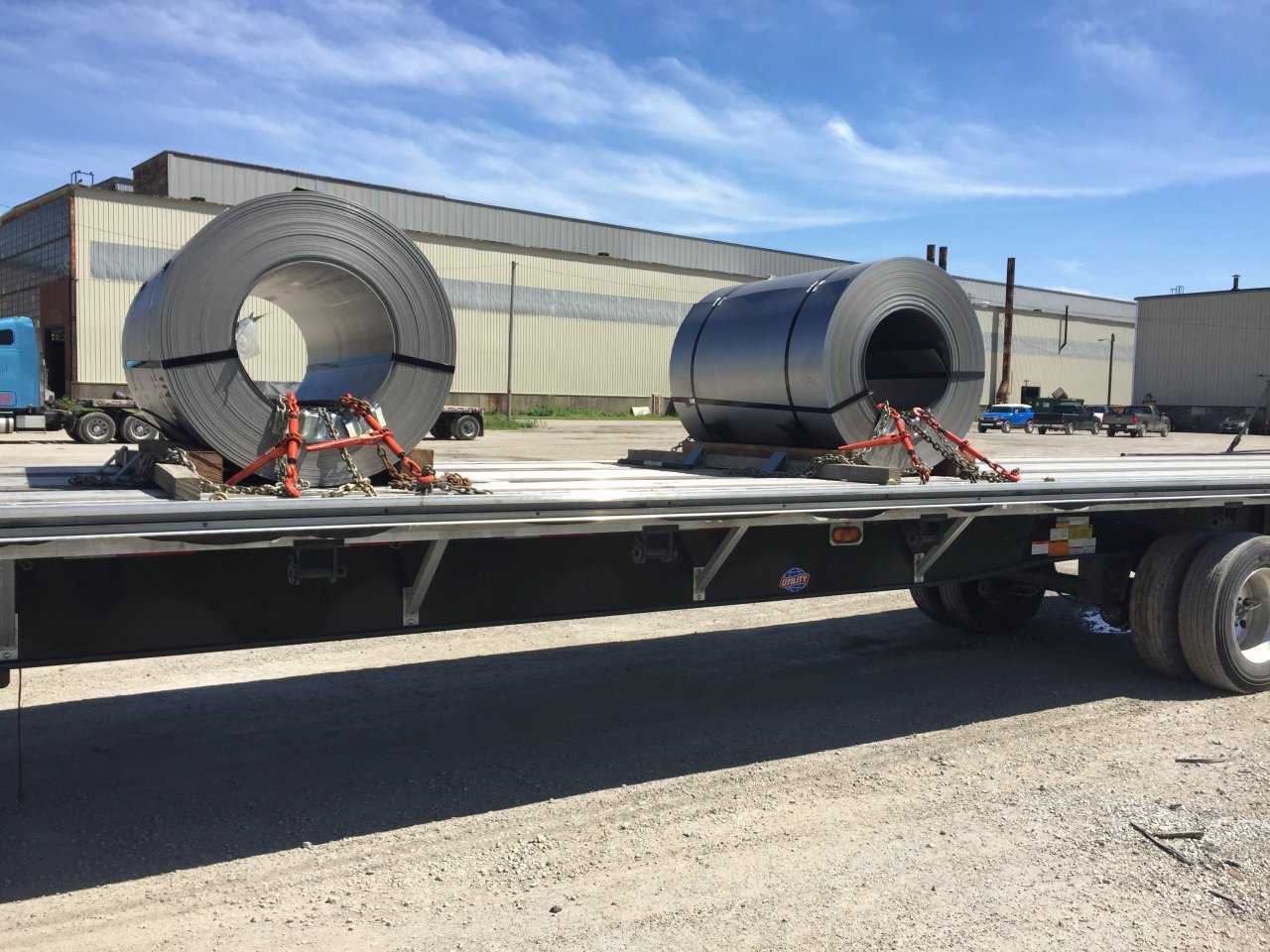

  10. kylefitzy
    kylefitzy Road Train Member
    4,660
    19,299
    Aug 12, 2007
    Kansas city,Mo
    Tri city canvas sells or sold big racks to use with 6x6’s on big single coils. They were made out of at least 4”x 5/16 or 3/8. We had to buy two sets in a pinch. I don’t remember a WLL on them but I don’t believe that’s required, never seen a wll on a piece of hardwood. IMG_0602.jpeg
    LTL Bull, Kyle G., Cat sdp and 10 others Thank this.
