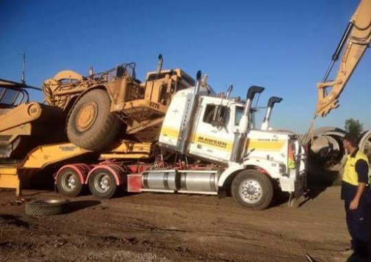

    @truckdad , do remember a similar picture that hung in the northbound scale at Castaic? It was a pretty gruesome reminder of what can happen.

    I saw one at Conejo of a 988 on the cab. The CHP had those at a lot of scales.
